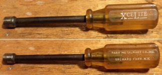

If the company name “Park”, the location “Orchard Park, N.Y.” and that brand name “XCEL” are ringing any bells for anyone, they should be! This is the same Orchard Park NY manufacturer who later made the famous and ubiquitous Xcelite brand socket drivers.
You can read the entire patent for the XCEL Adjustable Socket Wrench, owned by John Zilliox, on the USPTO site, linked here.
Zilliox owned a bunch of cool patents. Another one was the Interchangeable Head Wrench, basically a SOE wrench shank with removable heads of various service openings. GJ member Flatintoone found a whole kit (box, wrench, and all the heads!) in the inaugural 2012 Garage Sale thread, linked here, and RStewart found one with one size head back in 2017, linked here.

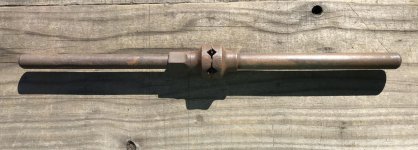

Here is a large unmarked tap holder that works on the same principle.
