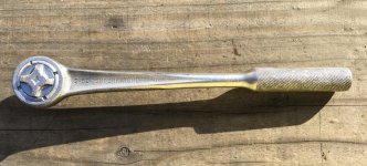

I posted this abused flea market find Superratchet on the Williams thread. I had to disassemble it repeatedly to repair damage from Bubba using it as a hammer. It would have been handy to have that special spanner. It would only work on my earlier ratchet as they changed my newer one. I ended up carefully using a pin punch.

I have a catalog from the 70s that shows these in it. (That catalog got lost when I moved but it is around here somewhere.) I used that to set up ebay alerts. As you stated, it appears that they used a standard spanner and machined down the pins to be the needed size.

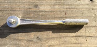

The enterprising collector with an S-52 Superratchet in need of some repair or lubrication who doesn't want to wait for Joe B. to kick the bucket could easily follow Williams' own factory construction lead and manufacture an S-52W for himself from a 420 face spanner wrench. EDIT: In fact, any 420 face spanner (7/32" diameter pins, 1-1/4" C to C) would do. It doesn't have to be a Williams. Here is a Fairmount I own, for example, almost certainly made by Williams for Fairmount, purchased at a flea market for $1, just waiting for a little grinding and/or file work to turn those round pins into the right size square pins, aided by Joe B.'s helpful photos above. :)
