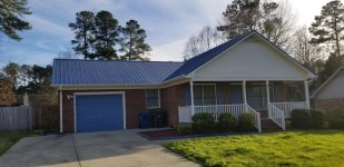

A roofing contractor is installing a metal roof on my rental house and 30 X 36 garage. It seem to me they are overtightening the screws which has dented the metal. Not only is it not pleasing to the eye to see all the dents but I am afraid it could lead to problems in the future. Should I raise the flag before they move forward with the garage? They have finish the house but suppose to start the garage next week, pending rain. In the picture you can see dent metal at every screw.

What’s under the metal? Asphalt shingles? A solid surface is needed to not have that deflection. It’s not from overtightening it’s from the uneven surface

Is it a reputable company that you hired. Do they have references, and finally what is their warranty

It's the same company that did my house five years ago and did a good job. They have expanded quite a bit and sometimes performance take a dive.

If it is installed over shingles that is normal. Another reason not to install over shingles. At least they used the proper rake trim.

Why did you have them install this OVER the old shingles? Ripping off the old roof is an easy DIY or a nominal expense when paying for a new roof.

Yes you are screwed. Why are you showing us pictures of the roof from across the street? Alot of roofs look good from a block away.

Because so many have said it's not a problem to install metal over shingles.

Strip to deck, re-sheet with min 5/8, high temp peel and stick the roof, 26ga double lock mechanical, full raised ridge vent, only proper way to do metal on a dwelling.
Alternatively a 2x4 double strapping system can be used which gives a full vented space from sofit to ridge under the metal panels, if roof venting is questionable. Also gives the chance to shim for dips and sags.
What you have sir I would put on sheds, storage buildings, barns, etc.
The shingle aggregates will slowly rub into the backside of those panels, with expansion & contraction.

First mistake- metal roof over shingles.
Second mistake- exposed fasteners. If I were to have a metal roof I would definitely go with a hidden fastener type of roof. Roofs with exposed fasteners have a washer- some are just rubber, better ones have neoprene. But, regardless of the fastener the roof system goes through expansion and contraction, to include the roofing itself. All this movement leads to leaks and structural damage. With a hidden fastener that problem doesn't exist.

It looks to me like the screws were over torqued, probably the clutch was set to tight and the guys were not paying attention. I would have laid down purlins above the shingles and screwed into those.

Second mistake is the real BIG problem and will be an on going issue for the life of the roof........:beer:

You should have removed the shingles first but if you were set on keeping them, the installer should had used purlins over the shingles. Those purlins needed to be properly screwed to the rafters and not just the decking.
With the difference in cold/heat expansion of the metal and shingles, you'll more than likely have water intrusion problems in the future. Another thing to consider, isn't there supposed to be a gap between the metal panel and the decking for proper moisture control?

My two metal roofs on house and garage are fastened on the ridge not on the flat surface...no dimples...
Been on for 20 plus years in snow country...no leaks.
Yours looks like ****...

When the screws are in the ribs a lever effect happens when the panel expands and contracts. It loosens the screw in the wood and enlarges the hole in the metal.

With a 1.25- 1.5" high panel you've got a lever arm of 5-6X the screw diameter. Doesn't take too many thermal cycles or sustained wind chatter to loosen them up.
You can't drive the screw in tight enough to seal properly on the peaks without distorting the ribs. You can pull everything up tight and ensure a trouble-free seal if you're screwing in a flat pan with a flat backer (plywood, purlins etc.)
Modern screws have the sealing surface completely covered by the washer head. UV degradation isn't a factor like it used to be with the big fat neoprene washers.
Most of the roof failures I've seen have been due to improper fastener installation. There are valid reasons why the panel and screw manufacturers recommend fastening in the pan.
Remember, Grandpa likely used washer head serrated nails, not screws. And his barn probably leaked- until he got up there with a bucket of tar to slather all over the nail heads.

There isn't a lot you can do now. I doubt the roofer is going to remove and reinstall for free. It's a rental. Be sure to get into the attic once/year and check for leaks. Sell in 8-9 yrs to beat the life expectancy problem.
