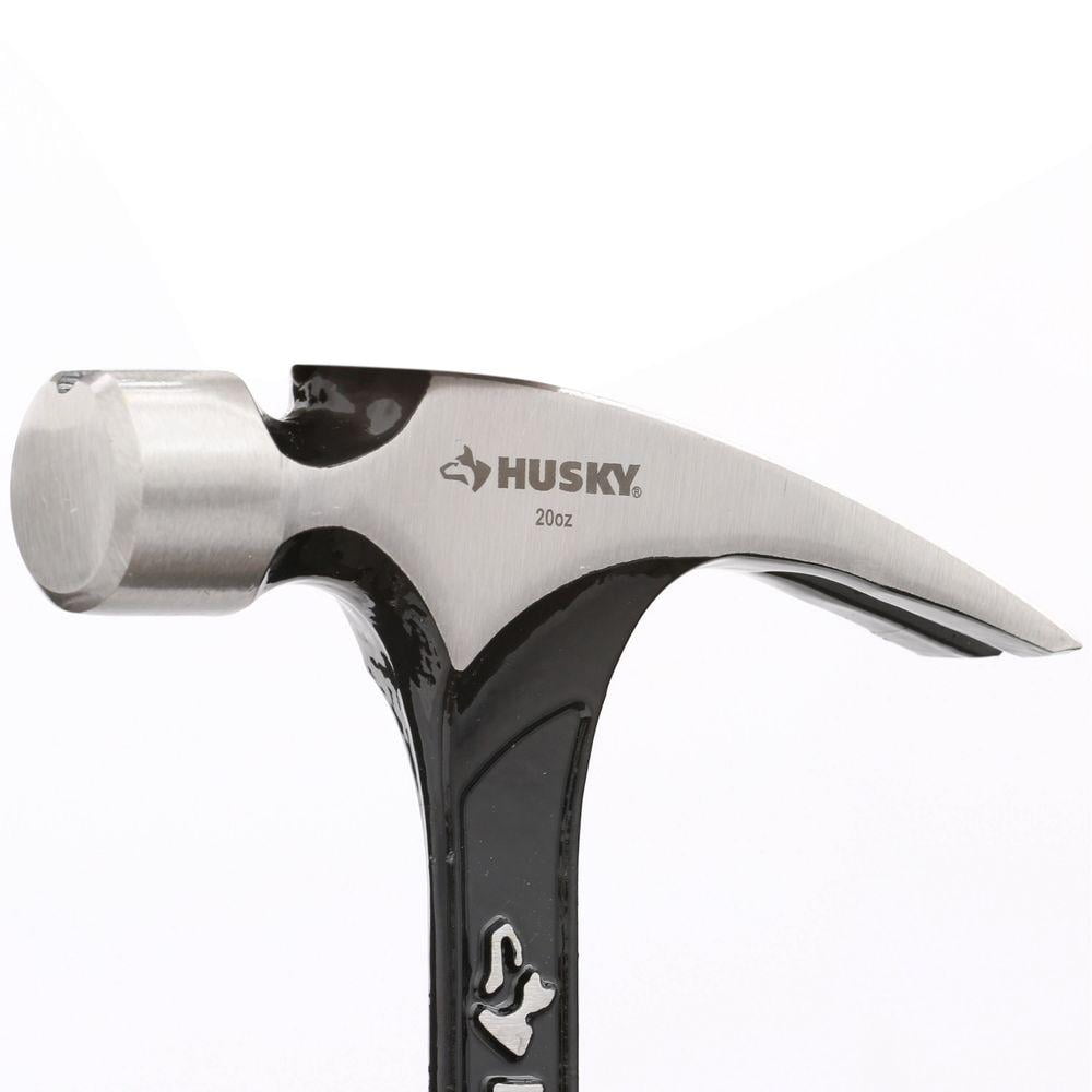

Just a thought but try to keep your tools at arms Reach. Every time you bend down to the ground to pick it up or use the mitre saw it adds up at the end of the day.
Learned this myself when I built my shed.
First blood? Now the shop is part of you. Enjoying the build So far.

Looks good. Yes a checkered face hammer would help, but a pneumatic nailer would be even better. I've had great luck with my $80 one from harbor freight.
Actually I did use a nailgun for the whole wall frame. But I'm worried a lot about blowing out the sides of the rafters when toenailing with it. I got a cheap Numax $80 one as well, but it has a flat face which makes getting the toenail angle pretty awkward (in my opinion). Maybe I'll try it on one and see how it goes.
I bet it has a cover over the toenailing shoe. If so, take it off and there will be a spiked tip
Holy **** you're right. I feel so dumb. Thank you :beer:

My last picture showed the garage with only a few rafters on. I did buy a framing hammer, that HAS actually had various uses and that are just different enough from a claw hammer to make it a worthwhile tool to have. It can really catch on those nailheads, especially toenail heads at an angle, to drive them home where necessary. I also did start toenailing with the nailgun instead of hand nailing 3.5" 16D's and I've gotten better with it. A Paslode airless nailer would be so sweet... ah, maybe if I do another big project in the future... Ok let's just do another huge photo dump with descriptions!
