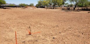

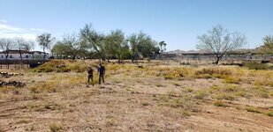

Backstory. I'm owner and operator of tt-motorsports.com and have been renting and dreaming of my own home based shop since I started out in 2010. Fast forward to this past November. My wife and I found a perfect home and property to make the dream come true. Sold my rental home in California and got started on the long process. After 2.5 months received the permits and finally getting it going.
Specs are red iron building from bunger steel building. 50x80 16ft eves. 3 12x14 roll up doors and 1 man door on north wall. West wall will have 12x12 roll up door which will open to a 25x50 lean to. Slab is going to be 5inch thick over 4in ABC. Should be a very nice upgrade from my 2000 sq ft current shop that is crammed packed with 3 vehicles and all my equipment.
I will be doing general welding and fabrication. Production suspension and offroad kits. As well as suspension and roll cage fabrication.
Breaking ground this weekend. Concrete should be formed up and poured the end of this month. April 2019. So progress will be a little slow until building is delivered end of may. Myself. My wife. Parents and friends will be erecting the building ourselves.

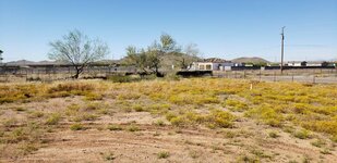

A little before and after of weed and dirt mount removal. Burned the weeds. Going to cut up trees we removed and trimmed and will burn those once they dry out.

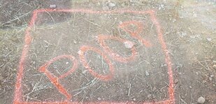

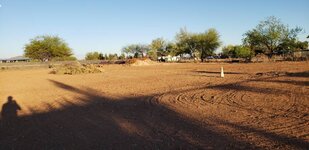

Got the corners marked out and cross measured to make sure its square. Also marked the spot for porta potty to be dropped off tomorrow. **** is getting real...c3792bb5dc95d859e3b8e9625297ab69.jpgbe27346417e51920e324208400f6adec.jpg914439901b4caf6ca11c73d678474b5a.jpg

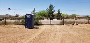

Digging footings begins Monday. Concrete guys got it marked Friday. Porta potty delivered. Ready to get this started. 6 months in the making to this point.

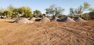

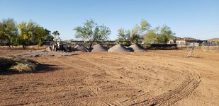

70 tons of ABC delivered today. Getting footings dug and this stuff processed tomorrow they said. Then forming up foundation for Inspection. Also going to have them pour 12in thick footings for my 2 2 post lifts.f421fafc48cd4d64e3959f75a701a0cf.jpg
