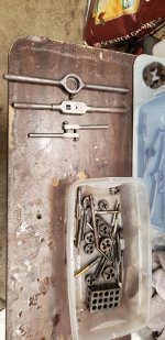

I have a small toolbox full of all my taps and dies, handles, ect.
I had left them in the barn for a while, the roof developed a leak, and I found the toolbox yesterday with about a half inch of water in the bottom. Needless to say everything in the box was covered in rust.
They have been soaking in vinegar and I have already taken out a few and the rust is coming off easily with steel wool and wire brushes. Then I'm hosing them with brake cleaner to rid the rusty vinegar liquid left on them.
I want to go a step further and coat them to help prevent future rust. Should I just hose them with wd40 then wipe them dry? Is there another fluid or oil I might have on hand that would be work well as a rust preventer? Or is it really necessary to buy one of these dedicated "tool oil or tool wax" coatings I'm seeing on google?

WD40 will just evaporate. I would use mineral oil, something that isn't disgusting to have over your hands if you are coating something like wrenches.

Thanks for all the suggestions guys. I added baking soda to the vinegar this morning, per suggestion. I just got done pulling a bunch more pieces. I rub a brass brush across each one, and get down in the nooks and crannies of each die. Then I hose them with brake cleaner to get the vinegar solution cleaned off.
I am extremely happy with the results, and impressed how easy its wiping off.
I have some ATF I'll put on a rag and wipe each piece before putting them away in a new case I have for them.
I'm also planning to get out some of my gun oils and will be using that on all of my handles, making sure to get the moving parts, set screws, and adjusters, well coated in the gun oil.
I also took the time to repaint my 2.5in die holder. It was originally painted. It was large enough though I didn't soak it, I just cleaned it with a wire wheel. I went with blue because, well, basically it was the only color I had in the cabinet. So now it matches my mini bike lol
Thanks for all the feedback guys

The baking soda should not be mixed directly with the vinegar, mix it with water to neutralize the acid after soaking in vinegar.
Whoops. I guess I screwed that up. It bubbled real neat when I added it in. Too late now though. Tools are all clean and rust free. I've got most of them wiped down with oil already and they all look good as new
