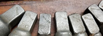

I recently acquired this set of primitive detachable crowfoot wrenches from a gent in New Jersey who found them at an estate sale.
I have no way of knowing if they originally came from the factory with this little coffin-shaped rack, but I suspect homemade on that. Either way it is easily as old as the wrenches.
It was caked with shop grime and nicotine residue when I got it. You can see where the wrenches left impressions from having hung there for so long. The construction is interesting, with a galvanized sheet steel backing.
Cleaning the grime off the wood took a good hour of gentle rubbing with Murphy’s, revealing that a previous owner made little crib notes about the sizes of the wrenches on the wood next to each square opening. More on that below.
I have a lot more to post, so bear with me...
(Post 1 of 7)

The guy who found them is an antiques dealer who does not normally carry tools. He was advertising it as “C.F. MILLER crowfoot wrenches,” but I found it odd that the “MILLER” stamping was above the “C.” and the “F.” on each piece, and much smaller, reading more naturally like “MILLER C.F.” to me.
I thought I recognized the “MILLER” stamping as the same "MILLER" stamping that is on the sockets that the Charles Miller Company made later in notable tools inventor Charles Miller’s career, well after his first venture (Miller Combination Tool), second venture (C.M.B. Wrench), and his licensing arrangement with Syracuse Wrench Company, which allowed Syracuse to use his 1907 ratchet (845,716) and T-handle (845,717) patents for royalties.
Also, Miller never used a middle initial, “F.” or any other letter, on any labels or in any business literature or official capacity. It was always either Charles Miller or just Miller.
Post 2 of 7

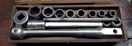

I’m going to post this Charles Miller No. 77 socket wrench set here at the end of my thread on Charles Miller crowfoot wrenches.
I already showed the set in post #2 upthread and it just makes sense. The crowfoot wrenches have 5/8-inch male drive tangs, just like the sockets, and they were turned with the same handles.
Miller was a prodigious inventor, involved in at least three other manufacturing outfits, from 1905 to 1912 or thereabouts, well before the era when he was making these crowfoot wrenches and socket wrench sets under his own name brand (1915 into early 20’s). He was a founder of the Miller Combination Tool Company, a co-founder of the C.M.B. Company, and he also collected royalties from the Syracuse Wrench Company. All three companies built tools based on his earliest patents (845,716, 845,717, 853,930, 952,435, and 952,436), which did not look anything like these tools.
The Charles Miller No. 77 set comes in a wooden box and includes a ratchet head, a T-handle, an extension, an L-shaped tommy bar, eight (8) hex sockets, and two (2) square sockets. All the pieces are made of malleable iron. The handles are nickel-plated.
Knowing how to stow the pieces in a fairly compact box was made a little easier by the illustration in the center of the lid decal.

None of the sockets have size markings. All the sockets have model numbers cast into the side with “MILLER” stamped diagonally on the tangs, just like the Miller crowfoot wrenches. Measured, the hex socket service openings are 1” (No. 9), 7/8” (No. 8), 13/16” (No. 7), 11/16” (No. 6), 5/8” (No. 5), 9/16” (No. 6c), 7/16” (No. 4c) and 1/2” (No. 4). The square sockets are 5/8” (No. 5) and 1/2” (No. 4).
This set is a much different design than the Miller Combination, C.M.B., and Syracuse sets that used his earliest patents. Here are the key Charles Miller patent pieces from a Syracuse “Champion” Set No. 12 set for comparison.
AA has a smaller No. 99 set in their collection and they postulate that his earlier patents covered these, too, but I am not convinced of that. The ratchet works on the same principle (a simple cam-faced spring-pin), and I suppose you could interpret the connecting end of the main handle (with openings in the front and sides) as incorporating the principle he used on the earlier sets, with a separate fixture (T-Head) for turning extensions into a T or L handle. But this is all a stretch, in my opinion.
I have not been able to find any period ads for this or any other Charles Miller Company socket set.

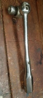

30,988
A few more...
And of course I just had to disassemble the ratchet head out of curiosity, and applied some grease before re-assembling.

Don't really have a better place to put this early (fixed, non-detachable) crowfoot wrench, but I reference them several times in this thread and show a figure of one in post #3, so I am going to post these photos here. Appears to have been forged by Herbrand under contract (see the logo in Pic 3). It was in that large lot of early fixed socket wrenches I ran into at the flea market yesterday and I couldn't leave it behind.

Nothing to add to the crowfoot subject but while digging thru my old stuff looking for some user non sparking tools I came across these which I'm sure, at the time, I threw in with the more modern tools because I didn't know where else to put them. Some kind of brass ish alloy. Non magnetic. I vaguely remember researching these way back in the day......anyway,.....more Miller examples.
P
30,988
Very cool, X! I have to admit, that whole Miller/Syracuse "Silverking" composition thing remains a mystery to me. I have two Miller sockets sets, the Miller crowfeet, and a Miller-made Syracuse Champion socket set and they are ALL ferrous, ALL magnetic. But according to period ads, some of them were apparently cast of "German silver" also called "silver metal", a copper-nickel alloy that is supposed to be similar to brass. The finish was silver colored though. Maybe that's what you have and the silver wore off? I don't know. Like I said, it's one of those things I haven't resolved yet.

The box has an ornate clasp (identical to the clasp on the Syracuse Champion No. 12 set)...
...and a marvelous paper label on the inside of the lid, reading "No. 77 Set" at the top, and "Charles Miller, Manufacturer, Syracuse N.Y.” at the bottom. Surrounding the branding and the set number are captioned illustrations of various configurations that can be accomplished with the handles and sockets.
Just for kicks, I duplicated the illustrations.
