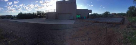

Next big house project was the big pour..... a 6800 sq ft wrap around driveway. its 22 ft wide at the front door so you can park and fit throught traffic and 15ft wide at the legs. It is tan colored with a rock salt and sweat finished.

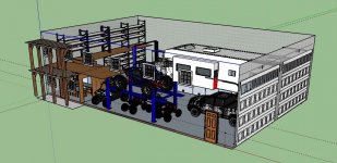

First step of planning my shop was to study my local zoning restrictions.
In my area a CR-1 zone the 2nd structure can not exceed 70% the primary structure foot print including covered patios and garage.
Our set backs are 4ft from the side yard and can not be closer than 3ft to the primary structure and height needs to be less than 24ft.
I can only fit 40ft wide with about 4in of margin between the house and the 4ft set back. I chose 60ft deep so I could pull the 40ft motor home in and still have room around the RV. Our RV with trailer is 70ft long and if I made the shop 80ft long the *** would be too close to the rear property line to be able to make the turn and pull through. at the shorter 60ft length I can drive the 70ft long rv and trailer through the rear door and out the front door for easy loading and unloading of toys.
Garage doors: one 16X14tall in the rear with side road access. Two 14ft tall doors in the front that connect to the driveway. the two front doors are at a 90 degree to the existing 3 car garage doors. Side man door points directly at the porch cover and will be past the two post lift on that garage door.
I modeled the layout in sketchup and made many iterations, this was one of my first iterations but not the final design.

Some slap form progress from the crew this afternoon after temps cooled downIMG_9131.jpgIMG_9132.jpgIMG_9133.jpg

Today the crew finished the forming and compacted the 30tons of ab. Tomorrow morning they will start the metal work. It’s been 106 degrees so we will likely wait till next Saturday to pour. Weather should drop to mid 90s next weekend.IMG_9138.jpg

Metal work is almost done, the slab prep crew is only working afternoons to beat the heat and working their real jobs in the mornings.
Tomorrow morning is the Skype pre slab inspection, we pour Saturday and temps should be reasonable.

If I could make one suggestion from a fellow fabricator with an RV, I would install a dividing wall or some type of barrier between the shop portion and the RV storage if at all possible.
When I built my 3k square foot detached I planned from the beginning a specific RV storage bay to keep any and all debris off of the RV, especially grinding and/or welding dust. I've seen too many friend's RV's end up with small rust spots on their expensive RV's due to the dust on them then getting into a rainstorm only to have small rust spots start, even on fiberglass roofs and sidewalls.
Also, maybe I missed it but I would go overboard on electrical. I put quad receptacles placed at every 6' and multiple 50-amp welder outlets placed around the shop to allow easy access no matter when I want my welders for any particular job.
Just some thoughts. Looking forward to the shop but also to the cars being built once the shop is completed.

Also on a side note, glad to see you install a proper sized RV door. A 16' wide door is a nice size to pull a large RV in/out and maneuver as needed. I see too many of my RV friends try to skimp and put in a either a 12' or 14' wide door. While 14' is a step in the right direction, a 12' door is tighter than people think until they actually pull their coaches through it then almost unanimously they comment about how they should have gone wider. In my opinion 16' is ideal.

Maybe an RV cover or curtain, but if projects get to dirty Ill just pull the RV out and park it in the drive way until I clean up or finish that project. I think most weekends and big projects the RV will end up living out side but wanted the option to store it indoors when the garage is clean and have the option to work on the RV indoors.
My biggest need for the RV doors is when we prep for a trip it seams like im moving a whole house loading up the trailers with tools and parts. I wanted to make sure I have enough space for the trailer in the garage shaded, cooled and lighted when loading or unloading. It was not reasonable to make the shop long enough to fit the 40ft motor home and 30ft trailer attached. If I made the shop 40x80 I would loose the turning radius needed to pull through my rear access driveway. As is I should be able to pull the full 70ft trailer RV combo through the back door with no jack knife reversing.
RV restoration will be one of my big projects next year in the shop. The whole RV was wrapped for SEMA afew years back and now the black wrap is all dried out and cracking. 5 years of AZ sun killed it.
