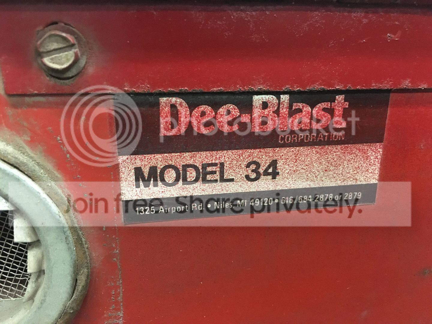

That cabinet is a beautiful color! @Falcon67
Are pleated cartridges good for blast cabinets?
I've noticed a lot of people use Wynn or Harbor Freight in their shops.
