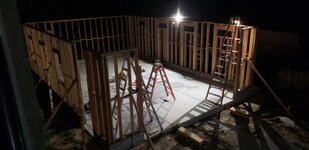

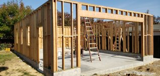

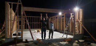

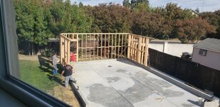

2019: Once high school baseball season, summer Legion Ball season and my son's first season of fall ball ended I began construction the second weekend of October. I'm fortunate enough to work for myself with one employee in the office and I basically worked from home for six weeks to get to the point I'm at right now. I would get up at about 5 a.m. and and work for my customers until about 8 or 9 a.m. and then work on my garage from 9 a.m. until dark, eat dinner and work for my customers until about 11 p.m. and repeat this process for 6 weeks. Weekends were 12+ hour days.
I had a contractor buddy draw-up a framing plan and come out and brush me up on framing skills for half a day and after that I ran with it. Got help from some extra local muscle raising my walls and solid 12 X 6 beam.ad7104e2f69672fa0c190afb0fcb0d4f.jpg0d596ace7b72ca08a6df779ae9f60f72.jpg
