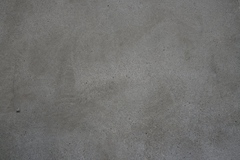

Pictures of the garage after it was cleared:
Pictures of the garage after 20 hrs grinding 400 sq ft of concrete with a handheld grinder. Pressured washed the slab twice and also mopped it to ensure no concrete dust was leftover:

Bondtite laid down as a primer. I used a 5 mil notched squeegee to spread it around. After just moving the squeegee around, I was worried I would not have enough material, but after back-rolling, everything was fine. I divided the Bondtite into 4 parts. 2/4 will be used for the top-coat, the other two were divided up so that I could do the garage in two halves. I think spiked shoes are a must for this type of project:
Liquatile laid down. Color is Silver Gray. Again, I split the liquatile into two batches and did one half of the garage, spread the decoflakes and than did the other half. As you can see in the close-up later, I personally could have done with just 3 lbs of flakes, but since I bought 12 lbs, I used every single one of it. Spreading the flakes was not that difficult. I have a couple of clumpy areas, one of which can be blamed on my neighbor interrupting as I was beginning a toss. I divided the flakes into bags of four and did each quadrant with a bag:

What does the epoxy cover up as far as imperfection in the concrete??
I'm hopefully going to be putting mine on this weekend.
Since it is self leveling, wouldn't it fill in smal cracks or divots?? If some parts of my floor are smoother and some rougher, will that show through?? I also caulked my control joints. They have a slightly concave finish to them. When I put down the epoxy will it lecel out over the joint making it invisible or will the epoxy settle into the concave joint making it visible??
AlphaGarage
Apr 16, 2008
1,298
Every Garage, AnyTown, USA
Looks great, nice job!
jmh - the epoxy does self level, but it tends to self level to an even flat surface, think of a bowl with marbles on the bottom filled with water. If you have patches that are rough you can flood them with a bit more epoxy to smooth out the spot.
Smaller low spots, dings and voids usually aren't a problem, ridges and point that stick up are, so try remove or grind them down during prep. Also the thicker the coating, the more it covers up contour problems.
The flakes also do a great job of masking imperfection. Even a small amount of flakes will help most floors, clearly if the floor is extremely rough using more epoxy and/or more flakes will help a lot.
