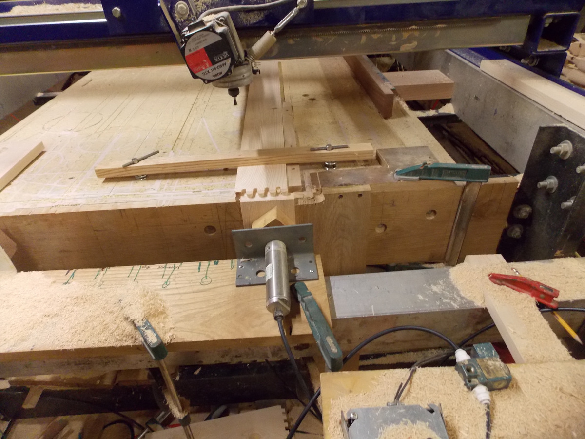

Got some time to dovetail the drawers I made a setup to do them on the CNC.
The wood is Hemlock I get it from a local sawmill kiln dry it then planed it down to 13/16.

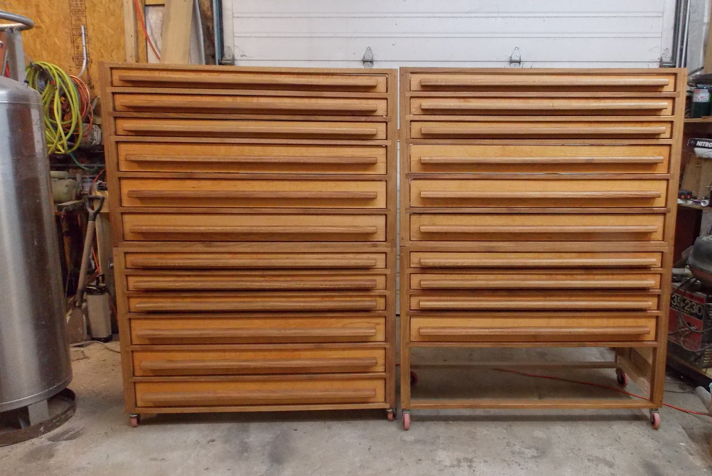

I got them mostly together, it was going to be 4 separate cabinets but I decided to stack them. I am not really going to be needing to roll them very often and I would rather have the floor space. though in doing that the drawer sequencing in size is mixed, good thing I am not ocd.
I went with cherry on the drawer faces the handles are red oak like the cabinets.
Need to make the one large drawer, that one will get dual slides.
I rubbed them down with linseed oil in a week I will spray satin Varathane floor finish to seal them up.

As a former cabinet maker at a high end shop, I applaud you. Very nicely done. You are a true craftsman. Those will last many lifetimes. You should put your makers mark and date manufactured on those.

Very Nice - but I have technical question if you don't mind me asking
When you installed the drawer slides, you used shims/spacers running from front to back so the slide would clear the face frame. Why do you mount the shims that way instead of vertically, top to bottom?
I usually use 3 shims per side, because I only use 3 screws to hold the slide to the carcass (front middle back). And, since the bottom of the carcass should be flat and level, I can mark the mounting location for each drawer slide on the shims (height above the bottom) before they get installed.
In your case, it looks like you had enough material on the front and back of the slide to screw into the carcass, and you would have only needed one vertical shim

Taycan, There is only about 1/4" overlap on the hardware and uprights.
The shims screw into the uprights and the vertical panel dividers. I put more than 3 screws in the slides, replaced what came with them with 1" screws.
