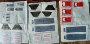

Mattblast has made wonderful replacement labels.
Except for the American flag to the right of the power switch.
I scanned my original above, but he just couldn't get the result he is happy with.
Can anyone point me to a source for a replacement or possibly scan one they have, in JPG or PNG format with lowest compression (biggest file size)?
Thank you. :thumbup:
