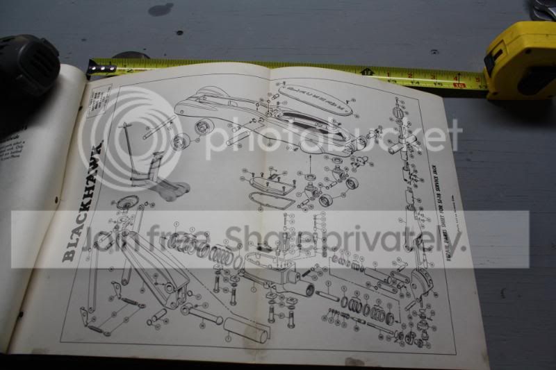

Anyone by chance have a detailed parts diagram for this unit? Google helps me find (which I suspect came from a different thread here)
- https://hosting.photobucket.com/albums/v708/2ManyCars/Tools/IMG_1887.jpg
But I can't quite get enough detail from this image to see what parts i'd need to fabricate to make this work.
I can take an educated guess, but if a more detailed parts diagram is handy (or better yet, someone has a parts cabinet with a knob to spare) that would be greatly appreciated.
Thanks!
--e

https://www.hcrcnow.com/shop/seal-kits/product/4743
Click the manual PDF at the above web page for drawings and parts.
Brilliant. Thanks! That level of detail is exactly what I was looking for!

The welded knob looks to be part number #74 found in the PDF @larry_g suggested.
If i can find a knob (thanks in advance @fl18guy for checking) I may be able to grind / file this down in an attempt to reuse it. If not, I'll try and use this as a template and fabricate some sort of hack of a replacement.
