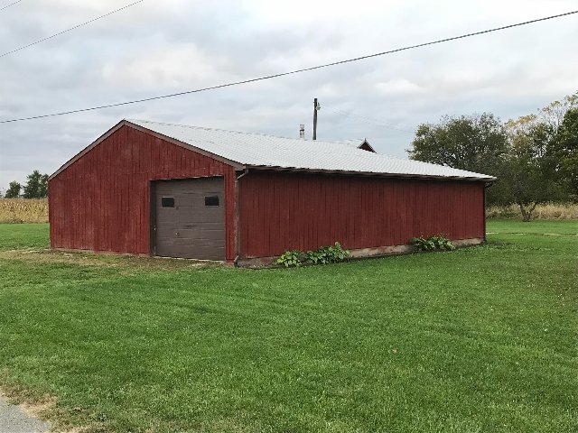

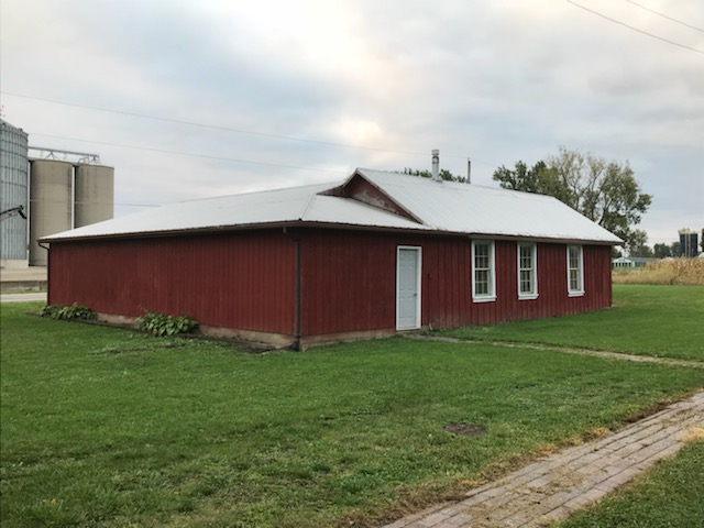

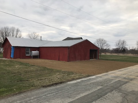

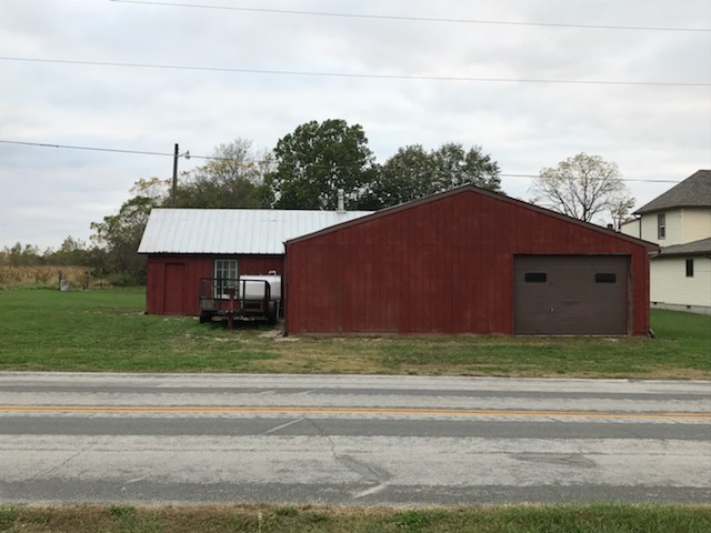

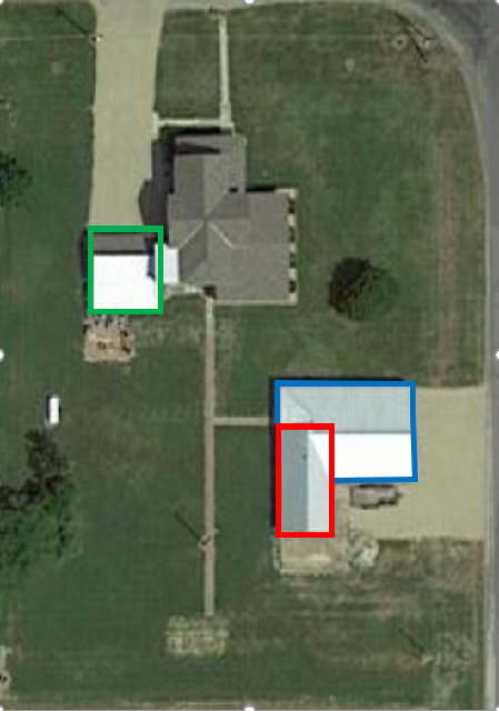

To start out, the green square is the 2-car attached garage. It is about 24x20 and houses our daily drivers along with some garden tools and bikes. I didn’t have anything to do to this other than rip out a crappy bench that was in the front of the garage.

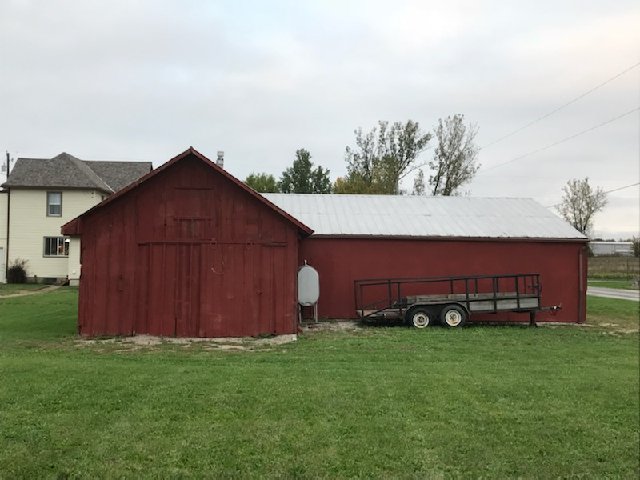

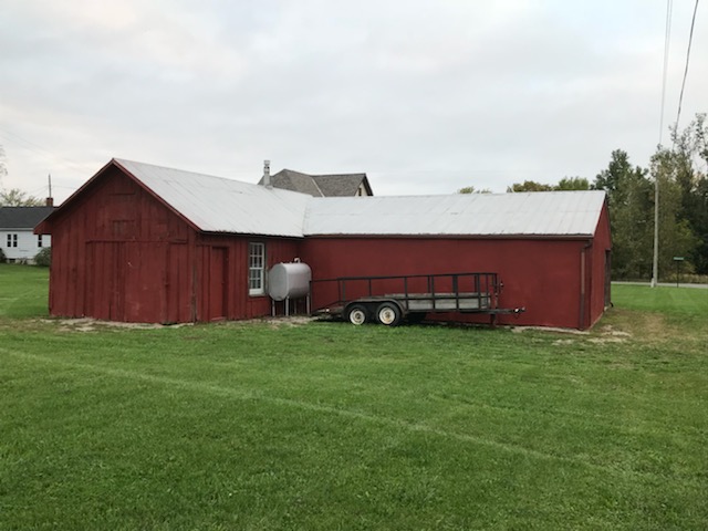

The real shop is the red and blue squares. The red square is the original shop and is about 35x15 and I use it as my woodshop. My neighbor who lives next door grew up in my house, so I know a little bit of the history. I am fairly close to train tracks that run both N-S and E-W and he said this building was originally part of a train depot near by and was moved to the property before he was born (he is in his late 60’s). The blue square is about 45x32 minus the 20x15 portion that is the woodshop. He didn’t have an exact date on when it was added on to the original shop but from the construction, I would guess sometime in the 80’s.
Looking SE out my back door.
Looking North.
Looking NW.
Looking West.
Looking SW.

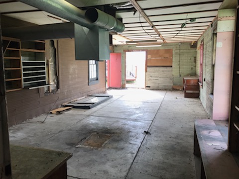

Here are 2 pictures of the woodshop before I started tearing into it. I eventually pulled out all the wallboard and “insulation”. They had used Styrofoam pieces held up in a grid pattern with some wood trim.
You step in the main door and turn immediately to the right to access the woodshop.
Looking back towards the entry.

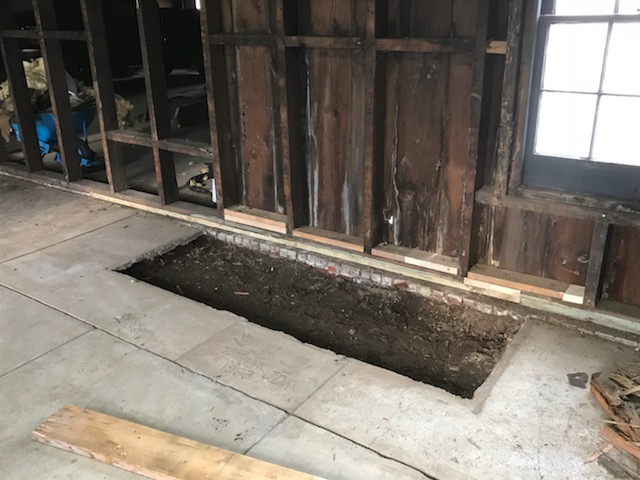

There originally was a brick floor and they poured about 2” of concrete over top, apparently in sections as money allowed. The story is that they had a very heavy bench that was never moved when the concrete was poured.

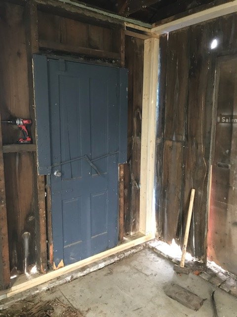

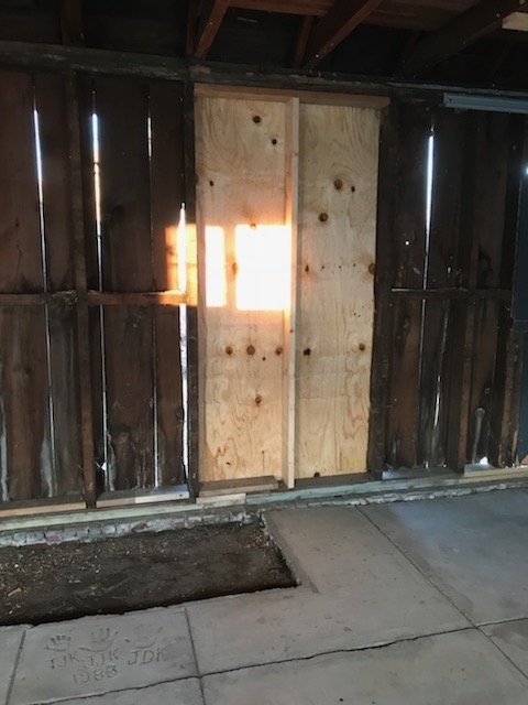

As you can also see in that picture, I had to replace most of the sill plate along that wall and I added a few blocks as well to reattach the outside sheeting. The fuel oil tank was in that area and there was no gutter. All the water just sat in that area. All said, I replaced about 16’ of sill plate. As sketchy as that was, trying to lift the wall with a set of farm jacks, I didn’t get any in process pictures.
I also replaced one badly rotten corner post.

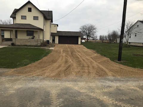

In the back yard there was a concrete pad that was in terrible place that supposedly had a chicken coop on it back in the day. It’s at the end of the brick sidewalk. That was where we wanted to put our garden in, so the pad had to go.
With the help of my truck driving/skid loader owning friend, we also got 4 loads of stone hauled in for both the shop and the house.
Once the rain washed off all of the dirt, it looked even better.

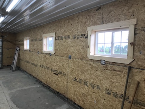

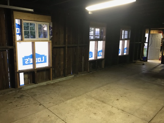

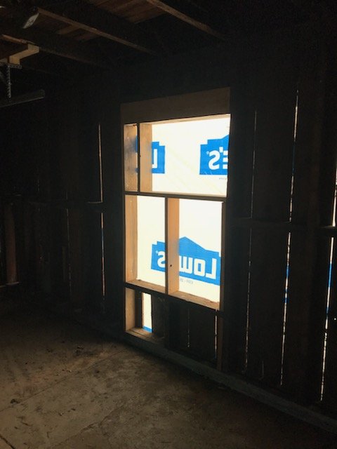

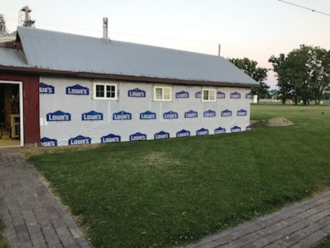

I decided to ditch the windows for something smaller, higher (prying eyes), and more energy efficient. I started by removing all the battens of the original siding and taking out the old windows. I then began to reframe for my new windows.
As you can see, I put on house wrap to help with the swiss cheese situation until I could afford to put new metal on the building. Spoiler alert: still no metal as of April 2020.
I also boarded over a window on the SE side which can’t be seen from the house.

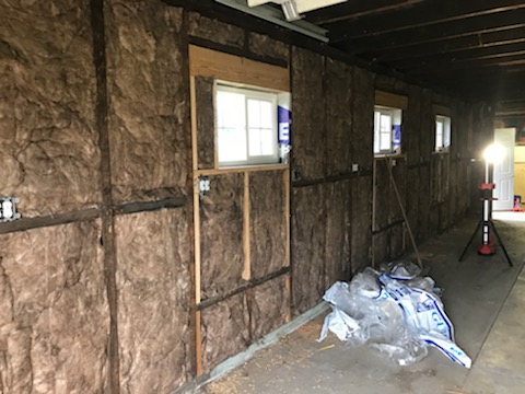

It was about January of 2018 at this point and my company was having some major issues and I got stuck working a 7pm-4am shift, 7 days a week for about 8 weeks. Progress was slow but I had a little bit of time to plan out my electrical situation due to my super messed up sleep schedule.
I don’t seem to have any pictures of just electrical. Insulation went up shortly after.

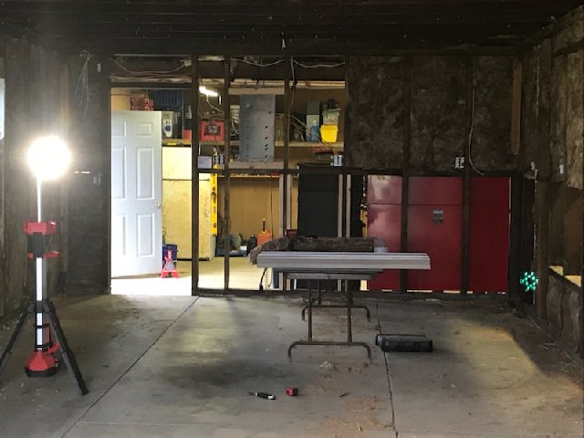

Electrical is super cheap to add when the walls are open, so I went pretty big. I got a huge Square D box from my brother’s employer for $50 and it was full of breakers to get me started. Previously there was a small box with about 5 breakers and no main disconnect. Luckily, the wire that was supplying the box was already big enough for a 100-amp service. All I had to do was put my box where I wanted it, reroute the main wiring, and swap in a 100-amp disconnect (box was previously 200 amp).
I ran 2 separate 120 circuits down each long wall. I also ran a total of 5 home run 240 circuits for future bigger machinery. Also added provisions for lights, outside lights, and a circuit in the ceiling for a future air cleaner.
Those 2 paragraphs represent hours and hours of planning. I also drew out my walls and ceiling to scale with studs and everything. If at anytime in the future I need to upgrade or change anything I know exactly where every wire is run. If anyone would like more explanation on this, please feel free to ask.

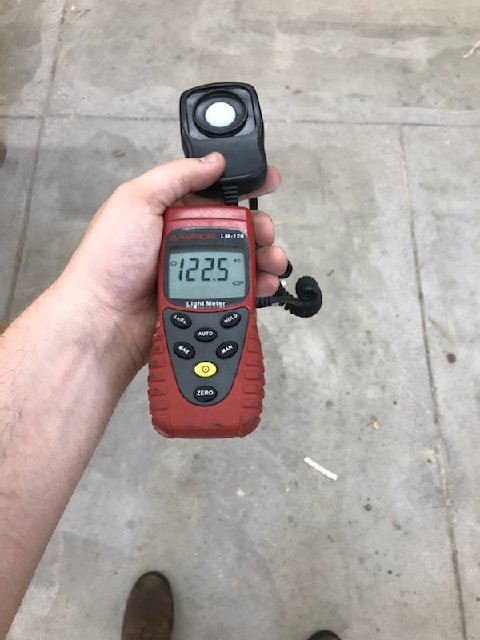

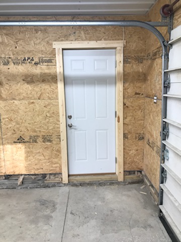

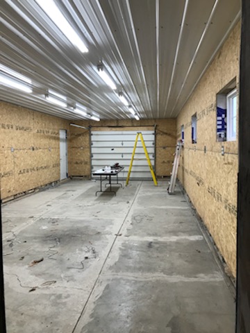

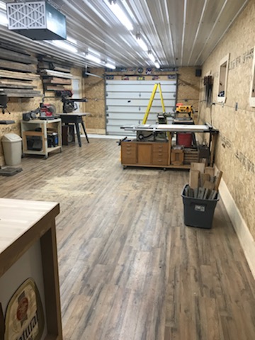

I don’t have any pictures of just the OSB going up, but here is a picture that shows quite a bit of work.
From the picture you can see that I took out the sliding door and added a regular garage door (no opener). I also took off the week of the 4th of July and hung up the OSB. Then with the help of my dad, brothers, and a good friend we got the ceiling metal and lights up. I went with 4-foot LED’s and love them.
In fact, I borrowed a light meter from an electrician at work to measure the foot-candles.

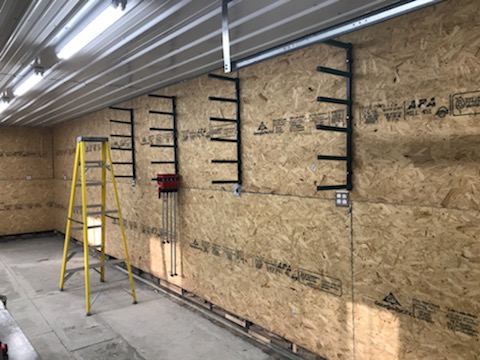

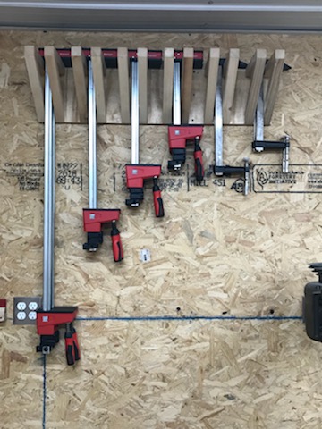

Once the wallboard and ceiling were up, it was game on. First thing I did was trim out the windows and man door. Apparently, I also put in the new man door and failed to take pictures of the progress.
I added some 1x8 and some cove trim to the bottom as well at some point.
I then hung up a lumber rack so I could start to clean some of the chaos on the other side of my shop.
These lumber racks are from Grizzly (around $25 for a set of 2). I have 5 total in the shop and absolutely love them.

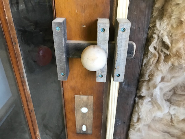

Next project was a door for the woodshop to try and contain dust. Previously there was no door, just an entryway. I used a glass door that I picked up from the curb.
I also fashioned a handle/lock myself. Free door, free handle. Win win.

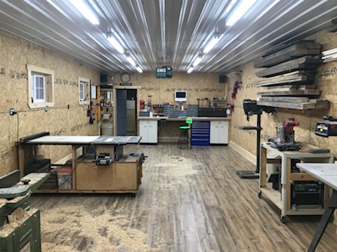

Finally, all of my equipment was moved in and I had a proper bench.
Looking in.
1st shop project in the new shop.

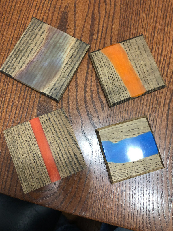

Here is a picture of some of the coasters. I think I made about 8 sets total. The boards I used were long enough to make 6 per set and I gifted them in sets of 5 so I could keep one from each step.
This was my first attempt with carving and epoxy so I learned quite a bit along the way.
I follow this guy on Instagram and this is where I stole the idea from.

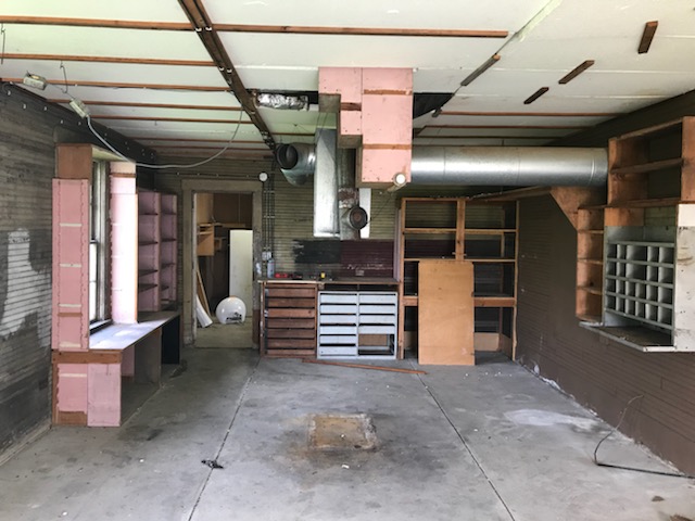

After Christmas I started working on the other section of the shop. Unfortunately, I never took any before pictures of this side. It had the same ceiling insulation, luan as wallboard, and a small amount of surface mount electrical. The one good thing that was already done was that the walls were already insulated and I definitely was not expecting that.
So, everything had to come down.

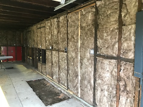

Now here comes the story that nobody will believe. Part of the ceiling insulation was fiberglass batts, but they were ratty, so they came down as well. At one point I pulled a batt down and heard something heavy hit the ground. I looked down from atop the ladder and see a gun on the floor. My initial thought was that it was a BB gun, but I couldn’t see an orange tip. I jumped down from the ladder to find a Sig Sauer P250 9mm with no magazine. I pulled back the slide to make sure it wasn’t loaded, and a spent casing fell out. I wasn’t exactly sure what to do so I just set it down and went back to work. About 2 batts later I heard another loud thud on the concrete and there sat the fully loaded magazine. Later, I talked to the local Sheriff (wife’s grandpa used to be a deputy so was comfortable with him). They had the owner on file and tried to contact him but failed and ultimately said I could keep it. This was over a couple month period.
