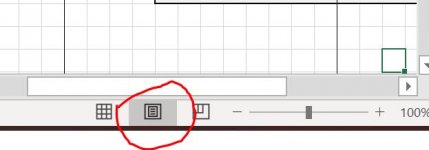

Really like the excel floor plan idea... how did you generate that/ do you have a template laying around?
Moving from a 2+ car deep garage to a 1 car around your size, so I too will be in maximize all available space mode

In a new sheet, I changed to "Page Layout" view (first image below). I selected all columns, and changed column width to 0.2", and selected all rows, and changed all row heights to 0.2". When you flip back to the normal view, the cells will be square. In all of my plans, I use 1 square = 1". I also filled all cells with a value of 1 so that as I drag a line across cells, I can keep track of length/height in inches. It's a lot of tedious work getting everything mapped out down to the inch, but it helps me triple check how all of the items fit together both relative to each other and relative to the studs.
