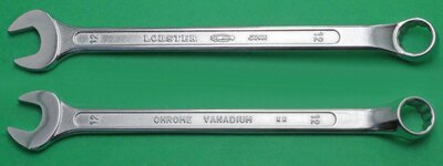

15. Lobster
Lobster is Japanese bland by Lobtex Co., Ltd..
Lobster logo is very unique.
English Web: https://www.lobtex.co.jp/english/tabid/130/Default.aspx
This is 2nd generation one, OEM by KTC/MS2 Item-6.
From 2001 to current
Comparing Lobster & KTC/MS2
1st generation was long DIN-type.
And this one was original products by Lobtex around 1980s.
This 1st generation had exported to Sweden for Samson (not Samsung), which is the agriculture products manufacturer, by Lobtex OEM.
Unfortunately, Samson wrench has not been found in Japan & Sweden.
Just model information has remained.
Attached photo is estimated one by Photoshop, not real one.

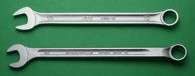

Those 2nd gen Lobster and KTC wrenches look similar to Stahlville's wrenches, having an I-beam. Are the ergonomic of these Japanese wrenches better or worse than their German counterparts?
C
corgibell
Dec 20, 2019
91
Tokyo
Stahlville is DIN shape with ring end offset around 30-degrees.
Please refer the side shape of the ring end by 2nd comparing photo.
This point is biggest difference between KTC & Stahlville.
I think KTC & Stahlville, both have own's character and are nice wrenches.

Thanks for the comparison photos. Stahlville looks thinner in the middle. I like that cup at the end too, seems more useful than your standard 15 degree tilt.
C
corgibell
Dec 20, 2019
91
Tokyo
Thanks for your reply.
If we focus to DIN shape, it would be better to compare 1st generation Lobster & Stahlville.
1st Lobster: Body Thickness 3.9mm, Weight 61grams
Stahlville: Body Thickness 4.3mm, Weight 63grams
By the way, all kinds of combination wrench have 15-degrees ring end offset, DIN also.
DIN shape is good for the concave place.
