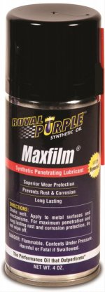

This works for me, I put the blocks in my tool boxes which will last about couple months and it smells good. That works if you keep it close up when not in use. Then next is this spray which I will spray a cloth rag and wipe down anything that I don't want to rust,which may require you to do couple time then maybe once month after. I use this on my TS, BS,mill and lathes,planer and jointer and all my hand tools.

Sawdust_
Mar 2, 2020
78
NY
I love this forum. I now have a few more options to try out, while I continue to seal up the old place.
1) Use the dehumidifier even in the leaky old building
2) Get a box fan
3) Buy some fluid film and some Maxfilm - both less expensive than some of the others I've tried (yes I have tried boseshield and LPS)
