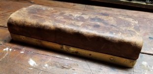

The case consists simply of a solid wood block bound with brass, with a sheet of oak-tanned leather as cover. There are no hinges or catches to break and no thin wood to smash. The leather also keeps the sockets from rattling.
Anyone who owns any early press-steel socket sets from any OEM – e.g., Mossberg, Smith & Hemenway, Eastern Machine Screw, Charles Miller, etc – knows that all of those things are true of all wooden socket set boxes.

Some additional photos of the case and its construction...

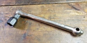

The tools are no slouches, either!
The hinge handle, which is nickeled, is more ingenious than they or their ad agency gave themselves credit for. Not only for the bulbous ball forged on the end that fits comfortably in the palm of your hand, or for the spring-loaded detent ball nestled inside that keeps the cross-bar firmly in place for it to be used like a T-bar, or for the seven (7) different offset hinge positions (stepped at 30*), but maybe especially for the way they turned the drive stud 45* on its axis on the hinge.
It’s not that any one of those features seems particularly unique now, in hindsight, but all of them together on a hinge handle in 1909 is unusual, utterly amazing to me, and seems way ahead of its time. In fact, other than the special version hinge handles that Snap-on made during WWII (M-10 9/32-inch drive, NS-10 1/2-inch drive, and L-10 3/4-inch drive)...
...I don’t recall seeing any other OEM mount the drive stud twisted one-quarter turn like that in orientation to the hinge and shank. If I'm wrong about that, someone please correct me.

Excited to announce that I have just completed a trade with elidas for his c. 1911 Eames ratchet adaptor, which is now resting comfortably with some of its brethren in my c. 1908 Eames automobile kit. This attachment, added by the M.I.T. alum Eames brothers to expand the utility of their original set, turns the already precocious hinge handle into a ratchet. The "EAMES" side up was for tightening, and the reverse side up was for loosening. Coarse, 12-tooth action, but for 1911, quite ingenious.
P
31,051
With the tommy bar in place, and the drive stud hinged vertically, it could be used to turn nuts in some hard to reach places.
That pin in this set is for a missing spark pug socket, but it's a handle spot for the attachment for now.
Back into the display case it goes!
