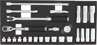

It's going to be between the KOKEN and HAZET then....
Whe WIlliams I can order of amazon uk and it won't be too expesive....
I could get this KOKEN set from Amazon Japan total price will be about £250 (taxes and duty included) I could save a bit more and buy once cry once...
https://www.amazon.co.uk/dp/B005I7HUDU/?tag=atomicindustr-21
Or the HP version Hazet for £190 or the old version Hazet for £150
I think I'll be better off in the long term with a 3/8 shallow + deep set like the Koken vs. 1/4 & 1/2 Hazet set ? any avice on this?

And one last proposal I can get this Williams 3/8 set and a set of Williams deep sockets for a about £160 delivered (taxes and everything included)...... not a bad price I think....
So it will be cheaper than the Hazet and the Koken....

Thanks! My car is a JDM Subaru so all I really need is metric 8 10 12 14 17 19 and thats about it....
Plenty of options to consider I really like the look of this Koken but It's a bit expesive for £260 but not soo much if compared to Snap On....decisions decisions :dunno:
And for some reason it seems you come out cheaper with buying a big set rather than getting everything separately....

All this for £160....
I can't justify spending £200 or more on a socket set as I'm not a professional and It's just for maintenance any big complex jobs the car will go to the professionals so It's not worth it for me.....
