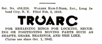

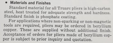

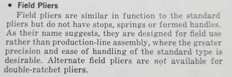

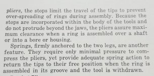

I paid more than I would've liked for these - a 1966 Rings Catalog, Catalog of Pliers and Assembly Tools, and Pliers Price List, but I'm glad I did.
Here are my notes...
1. It looks like we can go back at least as early as 1958 with these publications. See Pic 4.
2. My intuition was good on these catalogs having some backwards compatibility. The tables inside all include old model numbers for customers trying to figure out what new pliers to order based on their old pliers. This gives us the link between 1966 and the 1940's vintage pliers.
3. I thought I was missing a steel clip spring inside my No. 4 pliers, but they may be
what Waldes Truarc defined as "Field Pliers", which did not have stops, springs, or formed handles.
4. Tool-Scrounge's hunch was correct. Angle Tip pliers were special order and had the same model numbers as the same pliers with straight tips.
5. The handsome black finish on these is not black oxide, it's black phosphate.

Here are some excerpts from the GENERAL INFORMATION page...
