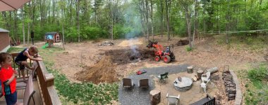

The clearing continued....
I knew the long-term plan was to put in a backyard for the kids, and to put up a building sometime in the future, the distant future.
Plans heated up in the fall of 2019 when I brought home this fine piece of American iron…
It’s an interesting story about how we ended up with this truck, maybe after the build I’ll post that too. That winter we paid for storage to keep the truck undercover for the winter. As we rolled into 2020, my wheels started turning about the “distant” building project. By springtime the wife was on board, and we were getting ******** into the site prep and getting quotes together for a barn/garage.
To Be Continued…
