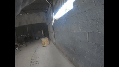

The steel building that I am renting was formerly a woodworking shop, here’s how it looked when I initially went to check it out
After it was emptied out, I did a lot of pressure washing..
And now its clean and ready to start moving stuff in-

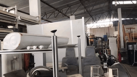

Unfortunately there isn’t really a good way to get vehicles in here- First job is solving this issue!!

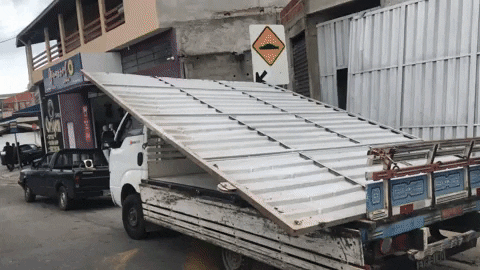

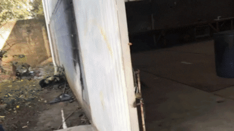

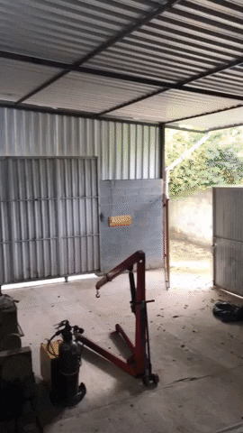

The First project that needed to be tackled was opening up the brick wall for a big access door, I found a sliding door used online and managed to get it home safely
I had to move a roof support and do bunch of other fabrication-I hired a proper welder to do any of the structural work and handled the rest myself. My favourite part was taking down the wall- I enjoy a bit of manual labor now and then.

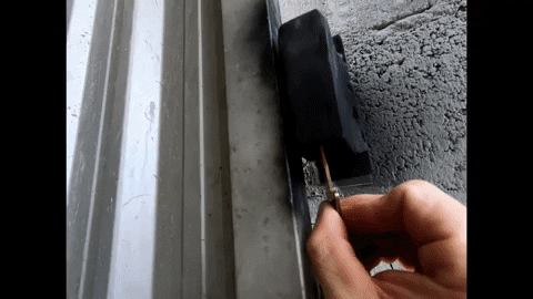

The door runs on a metal track(angle iron) that is bolted to the floor, it has a couple guide wheels above that keep it in place.
Here’s how it looked in the end, I made a little box for the pad lock for some added security- actually the whole shop could use a bit more security but we will address that as we go.

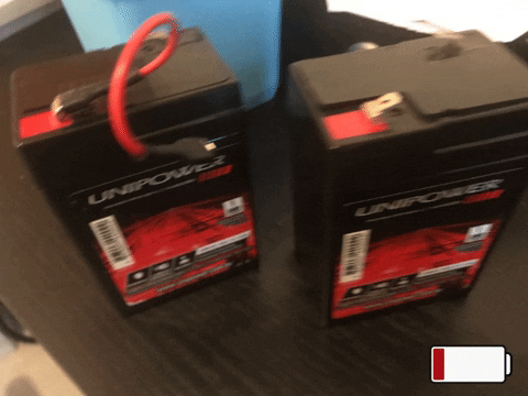

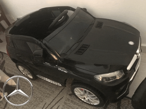

Alright, two posts in and I'm already side-tracked, here is the deal:
I have been fixing this 12V power wheels toy car for my buddy's kid
The charger wasn't working on it, and once I replaced that, I found that the two 6volt lead acid batteries are both shot.
I'm going to add some distilled water to the batteries and give them a good charge and they should be good to go.
However- my buddy bought two other batteries(which are also both dead) and so I have 4 total.
My question is this: If I was to install both sets of batteries in this car(2 and 2) in series(so that I still get 12V total), would there be any downside? I am thinking that the car should run twice as long but also take twice as long to charge.
Is there any potential downside to installing all 4?(other than the weight gain)
Sifan
Jul 10, 2018
586
Southern Illinois
I set my Granddaughter's powerwheel jeep up on lawn mower 12v batteries. Could buy 2 for what powerwheels wanted for 1. Put both batteries in with an A/B switch. She could give rides all day and never run both batteries down.
Great!! love the A/B switch idea. Thanks Sifan.

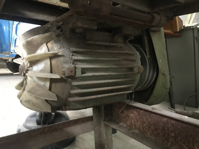

Ok, now lets get back on track-

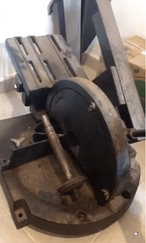

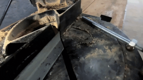

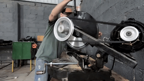

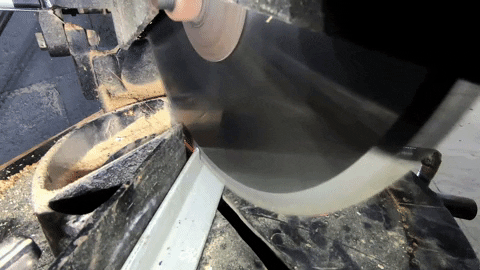

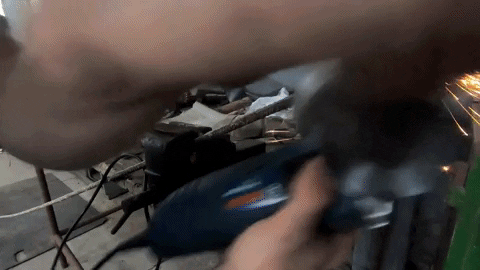

Scrounging together a Dry Cut saw
I have multiple projects in mind that will require the cutting of various sizes of square and round tubing. I don’t want to be stuck cutting everything with a grinder, it's time consuming and tedious to cut nice straight lines. I also don’t want an abrasive wheel chop saw because they just aren’t very accurate.
I could buy a bandsaw, but I can’t find anything decent down here for less than $1000 USD, and even for that price I am buying used junk at auction that will need to be rebuilt.
I would REALLY like a dry cut saw but because of Brazil’s crazy import taxes and regulations, stuff like the Evolution metal cutting saw(and other similar saws) are quite simply not available or completely out of my budget.
However I did find a national Brazilian company that makes metal cutting disks, and they are somewhat reasonably priced at $100USD.
So really, all I need is the rest of the saw…:D

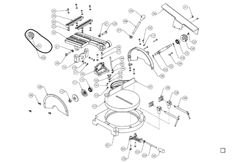

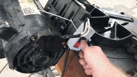

I found an old cast iron saw carcass for sale online for 50 bucks, it came with the spindle but the threads were stripped and it had no blade retaining nut.
I managed to find a drawing of the saw and sourced the bearings, snap rings, and retaining nut. Then I sat down with a file and fixed the threads on the spindle.
I found a good condition used single phase 2HP motor for about $80USD, lastly I picked up the remaining items- two pulleys, a belt, an on/off switch, a plug and some wire.
I put it all together and it worked!! I was very worried that the saw had been scrapped because of a bent spindle, but the spindle ran true!!

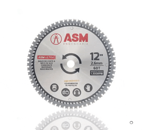

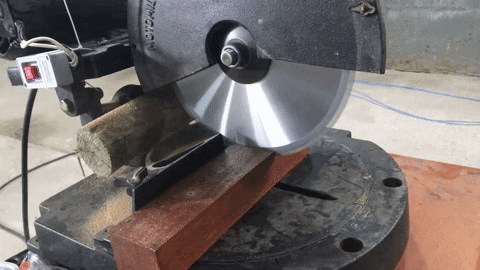

Now it was time for the big investment- the metal cutting blade. Check out the packaging, its just like opening up an old LP:
I did a test cut on wood:
Of course next I made a clamp- and now it cuts beautifully! I can’t believe the quality of cuts I am getting with this thing.
I have done about 30 cuts with the saw over the last week and one thing is clear: it works great, but it certainly isn't wining any awards for Safety
It needs:
A better blade guard
Properly mounted on/off switch with an E-stop
A Belt Guard
Bolt it down to the table, or maybe I will make a stand for it
Re-make or improve the work holding clamp
Would be nice to have some sort of digital angle finder for mitre cuts
Maybe mount a little laser pointer pointing down from the blade to help line up cuts easier
One thing at a time.
Thanks for reading.
Oh ya, one other thing- anyone have any idea if it would be worth it to install a coolant system on this thing to improve blade life??

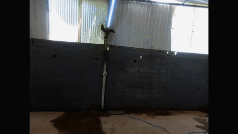

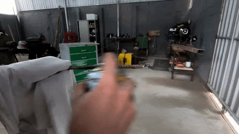

Let me introduce the workshop, its just out back..
Down this old country road
Squeeze under the old railway bridge
A little more dirt road..
And soon after you will arrive at a little town which, heading down one of the 4 roads you will find my place.
Here is how it looks from the outside, there is a little house, a car port, and of course the workshop
I haven’t really got anything inside the little house, the roof leaks in various places, even after I replaced a bunch of roof tiles, cleaned out the gutters, repaired a collapsed section of the roof and re-aligned all the roof tiles.So its pretty much empty for now, of course I have fridge in there for emergency cold snacks.
The back of the Carport has this amazing 3D Mural, it was all covered in mold, but I gave it a pressure washing and it came up nice, check out the 3D iguana, someone really put some time into this thing.
Beside the shop there is a lemon tree, and the neighbours Guava tree hangs way over the wall so I get a bunch of those as well.
Here is how the inside of the shop is looking today, not a whole lot to look at, at the moment, but we are getting there..
Just about time to start hunting down some old cars, I have few smaller projects to share first though…

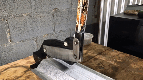

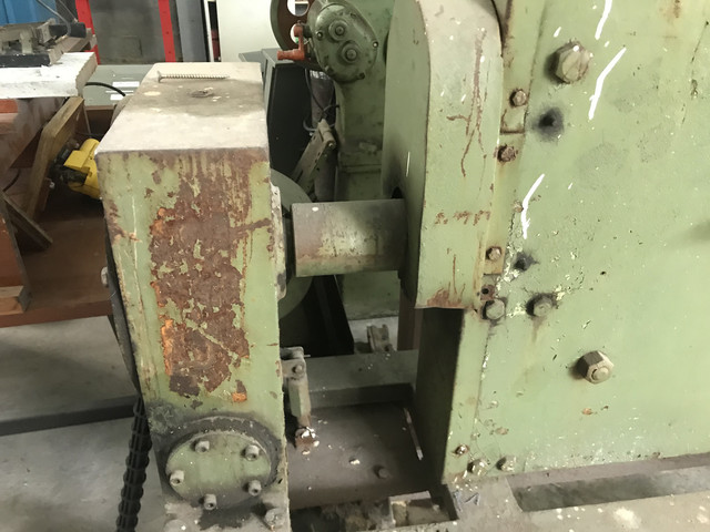

Quick post today- did a quick little clean up on this #4 shear, its made by a national Brazilian company called Somar.
I just typed Somar in google to do a little research and it turns out the’ve been around since 1929, and happen to be the first Brazilian company to produce a bench vice. Anyways I took it apart..
Gave it a cleaning, painted it
Added a little grease here and there, dialled in the blades(could use a bit of tweaking still to be honest).
And here she is:
I suppose I better get some pics of this thing in action as well, that will have to be in the next one..

And here’s some pretty unimpressive action from the shear- I bought some hold down bolts for it after this was filmed...

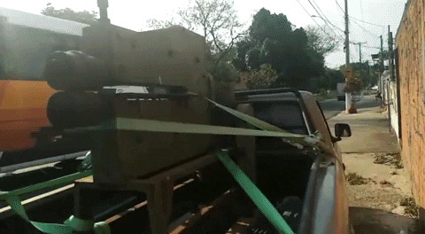

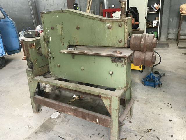

The Saga of the Giant Bead Roller
Early on(before I even rented the workshop) I made a bit of a mistake- I saw a bead roller that was up for sale for a really great price and just a couple hours away, so I jumped on it- I sent the seller a cash transfer without even seeing it and arranged to pick it up the next week
When I got there it was HUGE and super heavy duty- which sort of makes it an even better deal, but also means its a less than ideal tool for my use. It also runs on three phase power, but swapping the motor out wouldn’t be a huge deal.
The previous owner arrived with a boom truck and lowered in the back of my buddies Ranger.
It was nice drive back

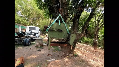

Of course I wasn’t going to be dragging this thing to my house, so I got my buddy to keep it under his tree for a few weeks while I was negotiating the rental contract for the shop.
To get it into my truck we used the strongest tree branch and wrapped it with the best ratchet strap of the bunch(NEVER use a ratchet strap to lift something[unless it was a good deal:angel:])
And here it sits today.
To get this thing going I would need to buy a motor or a phase convertor, and so the question is: Is there any reason I should hang on to this thing? Should I tear it apart and restore it? Would you even call this a Bead Roller??
Today I put it up for sale and if someone interested shows up I am ready to let it go. I probably shouldn't have bought this thing in the first place. We all make mistakes. :dunno:

Thanks for the suggestion on the saw- the manufacturer recommends 1300RPM which is what I've got it spinning at. I do agree with you that it shouldn't be throwing sparks, I'm going to shoot the company a quick email with that clip and see what they say. I am pretty much at the limit with the two pulleys so slowing it down would mean purchasing a low speed motor.

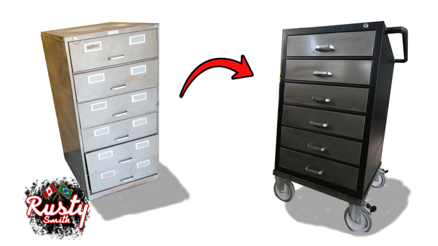

Time for another update- Did a quick little project a couple weeks ago, taking an old filing cabinet and turning it into a toolbox.
Made a video about it, just me joking around (pretty sure I spent longer editing the video than making the box…)
Sure would like a little feedback if you've got a minute
In case video isn’t your thing, here are the details:

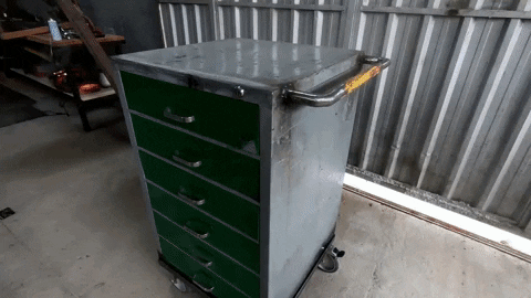

I bought this old filing cabinet from a barber that had recently closed, its a little grungy but it has potential, and the drawers are very well made!!
First up I made a base for it
Added some wheels
Of course it needed a handle
And finally a quick paint job-

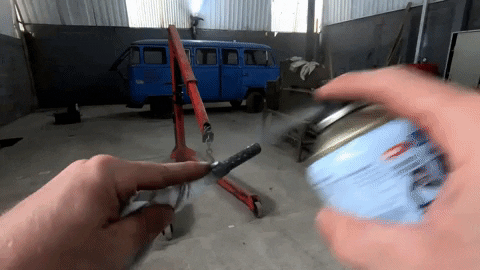

Now let me stop here and give you guys a quick paint “tech tip”
I have noticed that alot of you are still wasting time painting stuff with brushes or rollers, or even spray cans.
What if I told you that a quality finish could be achieved with just the flick of your wrist!?
Let me introduce you to The Paint Stick
What you're gonna need is a small length of rebar- I recommend taking a flap disc to it just to take off the high edges
Next up you need a little- Just a little of the color that you want your project(toolbox/car/boat/house) to be painted
Apply it sparingly to the rebar- here you see me apply the black(main color)
Then the silver(accent color)
Finally its just a matter of deep concentration, divine connection, and a well placed tap:
Next I added some rubber matting inside the drawers,
And here’s how it looked in the end:
Thanks for Reading!!

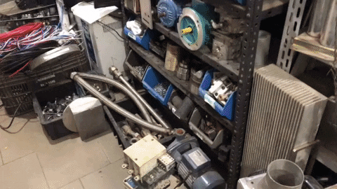

This is the first place I checked out, they’ve got everything from industrial production equipment to furniture.
Lots of steel, but its was mostly in very rough shape
Here’s a couple more little vids, not a whole lot of what I was looking for unfortunately
Picked up a couple things anyways just to see how they would be to bargain
This says “danger stay away" already have it hung up

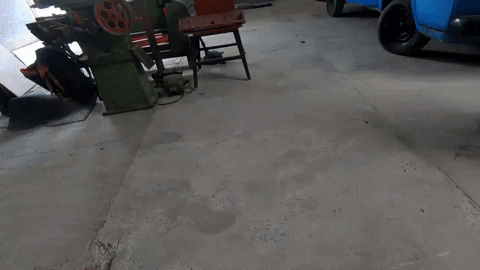

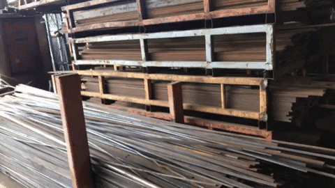

This place was absolutely huge, they had 6 giant warehouses packed with used steel, they also had an enormous yard that was full of all kinds of huge heavy industrial production equipment.
The quality of the used steel and parts at this place was much better
I didn’t take too many pictures, but you get the idea
They also had this machine for cutting steel, I believe its called an eccentric press or eccentric shear??
By the time I had walked the whole place it was already closing, I'll have to go back another day and actually buy what I need!!

Picked up this old Starrett bandsaw just after I had bought all the stuff for my cold cut saw, it wasn’t working and its missing some pieces, but I figured it would be a good back-up plan if my cold cut saw idea didn’t pan out.
I finally got around to having a look at it, at first I thought it needed a capacitor because when I plugged it in and turned it on it would just make a buzzing sound, no spinning.
But it turns out the governor that switches on and off the starter capacitor was simply missing a screw causing the circuit to short out. Here it is with the two screws installed. If you don’t know- the governor switch in an electric motor starts in the closed position allowing the starter capacitor to get the motor spinning and then disengages after it is up to speed.(I’m no motor expert but I learned a lot from a guy called Jeremy Fielding on YouTube)
The on/off switch housing was so dried out that it cracked up when I took it apart, so I re-made with a bit of cutting board and super glue… (no fancy 3d printed switch housings in this thread..)
I hung onto it for a week, but the cold cut saw is working fine, so I gave it a cleaning and put it up for sale, it still needs a blade, blade guide, and a work holding clamp and I’ve got other projects on the go.
The guy who bought it got a fair price, and I learned some stuff about electric motors + doubled my money

Oh ya- I gave this other cabinet a tap with the paint stick on the way out

First up, I bought a shaper a few months ago. I always wanted a shaper and it was going so cheap that I couldn’t resist even though I have no use for it what so ever at the moment.
Its a “Joba” and I don’t know a whole lot other than that. Haven’t even fired it up yet. I’ll take some better pics of it soon enough. You can see the vice sitting in the lower right of the picture
