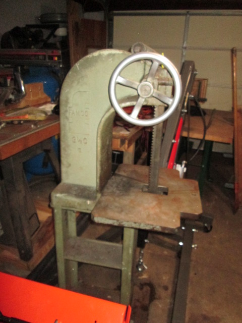

I picked up this Famco 3-1/2 C in January of 2020 from a online auction!

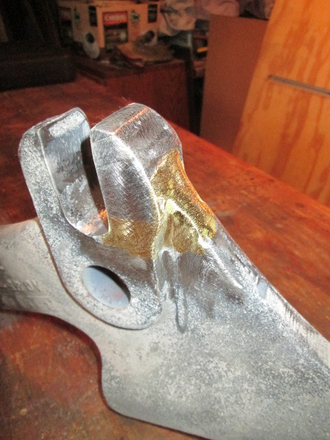

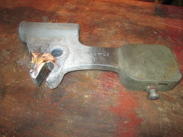

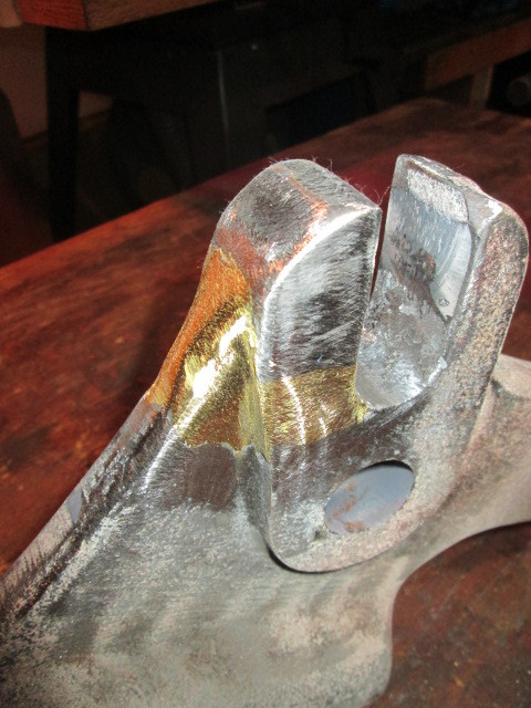

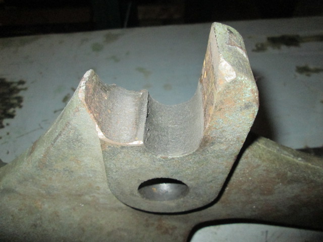

The pivot/arm was damaged & it needed to be repaired, But because of the damage I was able to get it for $150. Considering what these arbor press go for I figured I could come up with some way to fix it. :headscrat
Being the pivot arm was cast-iron I originally thought of trying to weld a new piece of metal to it with some nickel welding rod.
After checking around a little I decided to go with brazing a piece in-place. Being I don't have a large enough torch to braze something as thick as this :(
I took it to a local welder that I have dealt with before. I had already shaped a piece of metal to roughly fit the worn out area, So all I needed was to have it brazed in place. My local welder did a great job & even ground it to shape after brazing.

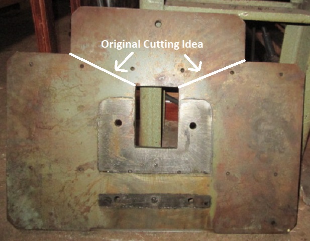

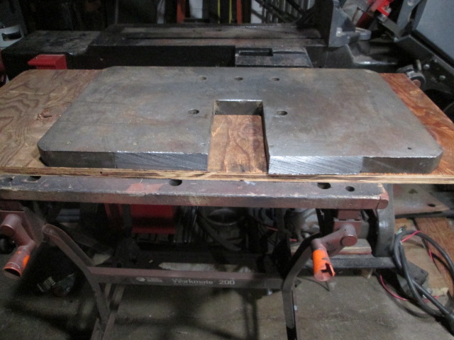

The arbor press originally had a square hole in the top plate that made it hard to get something like a shaft/bearing assembly under the ram.

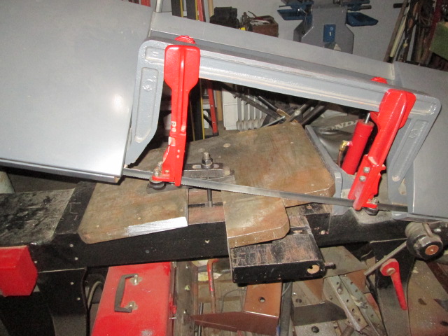

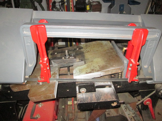

I was going to just try cutting the plate with a angle grinder, But the plate is 1-1/4" thick & I figured that it would be pretty hard to get a clean cut on something that thick.

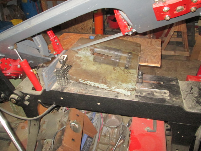

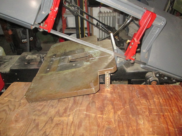

After thinking things over a little I figured out a way to get the plate to fit on my Kalamazoo 816 Bandsaw
Being the plate was larger than my bandsaw's capacity, I removed the rear vise jaw & used a clamp block in it's place. Then I tilted the plate to make cuts into the center of the square hole.
I'm still planning to disassemble it & clean it up and repaint it!
However for now it's working fine & I use it often.

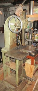

Here's a YouTube Video That shows how the compound mechanism works.
(Also a example of what my press could look like once cleaned up & repainted)
Here's a few more pics of the ratchet mechanism that controls the arms movement.

Doug you did a fantastic job getting that compound arm repaired. My 3 1/2 C has some wear on that arm as well, not quite as bad as yours was. For what little bit of pressing I will be doing in my basement shop I don’t think I will get mine repaired. It is just amazing to me to think about just how many pulls on that lever it would have taken to wear that down like that.
Cutting & grinding a part to fit wasn't that hard!
The brazing job the welder did was a lot better than I had expected, He has a big pre-heat oven that he heats the part up to about 800 degrees before brazing or welding. After the brazing/welding process he places the part on a warming rack that slowly drops the part temp down to around 200 degrees.
The biggest shock to me was that he only charged me $60 to braze the part. :D
Yeah I'm shocked at some of the items I've ran across that have ben miss-used or abused.
The bar on the arm was bent about 20 degrees when I first got it, So someone was probably really pulling on that arm in the past to bend a 1" dia. 4 foot long bar. :wtf:
I straightened it out pretty well, But there's still a little curve to the bar.
