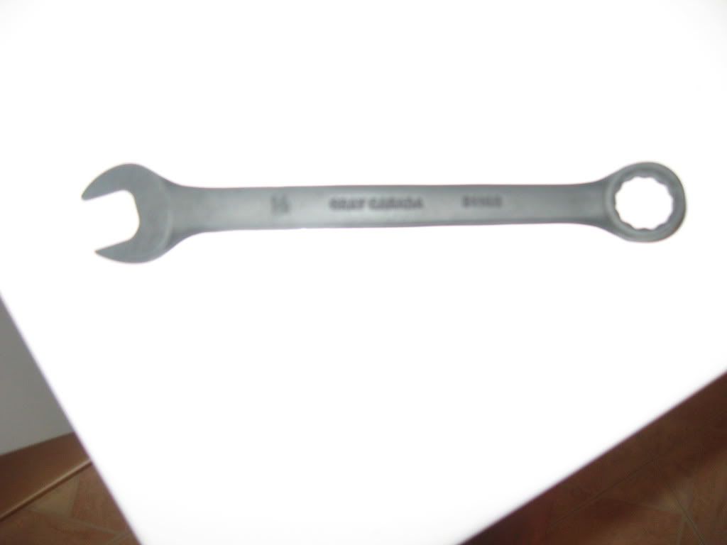

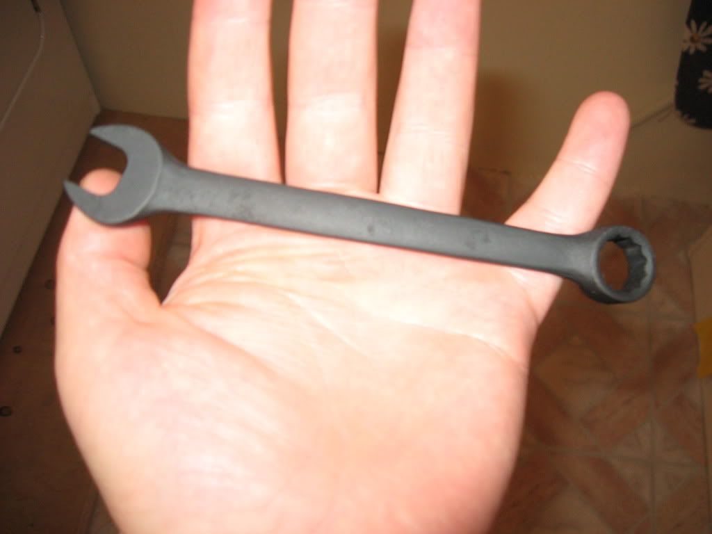

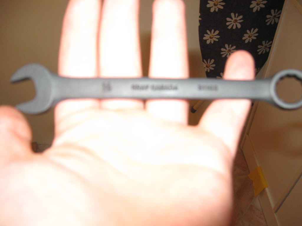

Hi all
At my work we have a black oxide coating stsyem called Blackfast its a very easy process to coat somthing
Today I black oxide coated a gray 1/2'' combo wrench
First step was to clean the rust off the wrench
I used a sand blaster with a very fine aluminum oxide sand or very fine glass beads for lightly rusted parts or just a touch up
The coating is applyed in a 4 chemical bath system with 3 water rinses
1st a degreaser (leave for 1-20 min) no real time limit
2nd a water rinse (leave for 1-5 min)
3ed the conditioner (leave for 15sec no longer!)
4th a water rinse (1min)
5th the black oxide coating (dip for 10sec check for even distribution then set it back in for 1min)
6th water rinse (1min)
7th De watering oil (1-30min) no real time limit
When you take it out of the de watering oil you blow it off with an airgun and it turns lilly white because of the calcium comming out of the coating.
After a quick whipe with WD40 its good to go
The finnish is very durable and can be re applied any time
Heres the end resulte sorry for no pictures of the process I dont want to bring my camera to work.
sorry for the blurry pictures

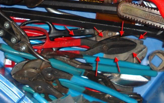

I worked at a place that had the black oxide treatment too, I think our was heated but I'm not 100% sure (we also a had hot wax machine to put wax on sharpened tooling), does your process use heat?
I did the shears with the red painted handles below about 15 years ago and they've held up pretty well:

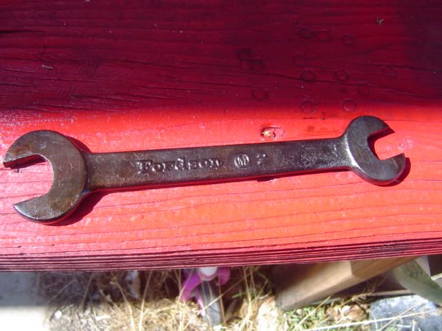

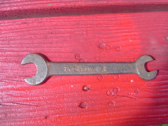

Another alternative is a blowtorch & old motor oil. Heat the part, dip it in the oil, heat the part, dip it in the oil, heat the part, dip it in the oil... repeat repeat repeat..
Very shortly you'l have a shiny, jet black coating on the part.
Also happens to be a method of case hardening.......
I wouldn't try that on my tools though.

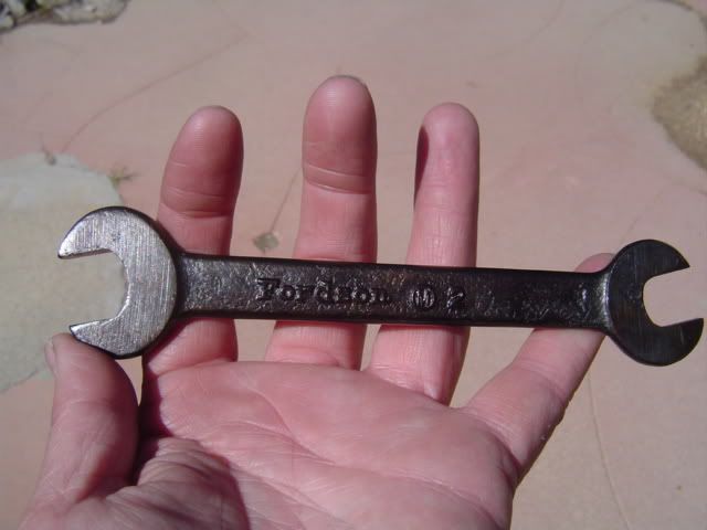

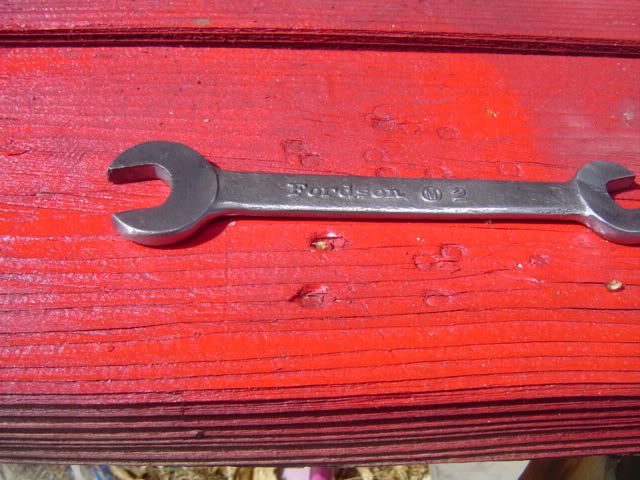

I did this yesterday:
$2 got me this:

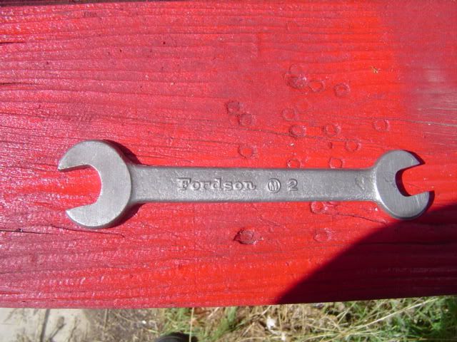

Beadblasted:
Deburred etc:
Back in the blaster:

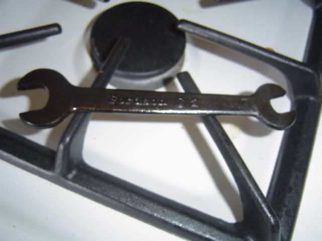

In process:
Done:
Cooling down:
Finished:

How hot do you have to get the part though hot enough it will effect the steel?

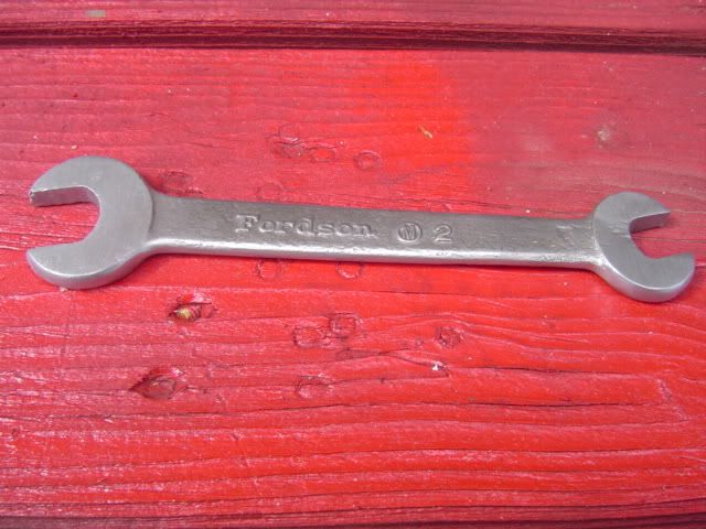

Not very, just hot enough to burn the oil basically. The oil bubbles a bit when you dip the tool & then the oil on the tool ights off when you hit it with the torch.
Metal wasn't even glowing dull red, just too dang hot to touch.
Did this one last week:
