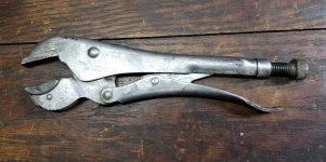

I snagged these at the flea market on Friday morning specifically because I had never seen the name before in the wild or online. With the PAT PEND marking, made sometime between 1945 and 1949. A quick search reveals only one reference on the GJ vintage board, and that is in 4.c's 'US Mfgrs' A-Z list thread. I couldn't find any other examples. Happy to provide the ̶f̶i̶r̶s̶t̶ second!

As with most other locking plier-wrench type tools not named "Vise-Grip," they attempt to improve on one of the issues with Petersen's design. In this case, it's that pivoting lower jaw, which is meant to keep the jaws parallel as the opening increases or decreases for different work pieces.

Mine is the same size. According to ads they ran in 1947, they called it 10". I haven't found any evidence of other sizes, but it makes sense that they would. Most locking plier-wrench makers did.
Please inspect your pivoting jaw. The example I found matches the patent drawing. One pin for the pivot, and another pin as a stopper on its range of motion. According to DATAMP, there is another later and much more common variant with a different design where a single pin acts as the pivot and the stopper.

You're welcome. Just when you think you've seen every possible imitator/improvement (e.g., B.M.C., Gripso, Seymour Smith, etc) there is to be seen, yet another "Vise-Grip" shows up! :)

I want to amend what I said in post #2. I do believe the pivoting/sliding insert serves to keep the jaws parallel as the jaws open or close, but it also allows their use on workpieces that are not square, as the 1947 Popular Science ad shows.

DATAMP does discuss two variants, but the only difference between the two that they address is how the sliding jaw insert is attached and restrained, as I discussed upthread.
In the patent drawing, there are two pins. One holds the sliding jaw insert on the lower jaw and also provides the sliding or pivoting action; the second provides a stop. That is the example I have. See post #2. In Pics 1, 2, & 3 I have the jaws wider open and you can see where there is a little hook on the sliding insert that catches on the second pin in Pic 3. In Pics 4, 5, & 6 I have the jaws closed much narrower and you can see where the insert with the little catch is slid back.
In the second variant, there is only one pin. According to Mike (wrenchguy), that is the example he has. But note that per Mike, his is also marked PAT PEND, which means Whale Tool Corp made that change before the patent was granted. (Mike - if you're reading - please post a photo of your jaw insert so we can see what that second variant with only one pin looks like.)
You NOS beauty is also a one-pin model, and it has the patent number.
So, two mechanical variants, both of them in the 1945-1949 range, both of them marked PAT PEND. And a third variant that is the second mechanical variant, but marked with the patent number where the PAT PEND used to be, made after 1949.

At the very bottom end of the handle, where the adjustment screw enters,it looks like there was a change made. If you zoom in on that datamp photo of the two you can tell, and yours and mine appear to be different there.

Yes, I see what you mean now. Of the two example images DATAMP is showing in their patent/example summary info page, the one on the top is a two-pinner with a collar at the end of the handle frame, like mine, while the one on the bottom is a one-pinner without a collar, like yours. It seems like a cosmetic difference or a difference in manufacturing processes.
