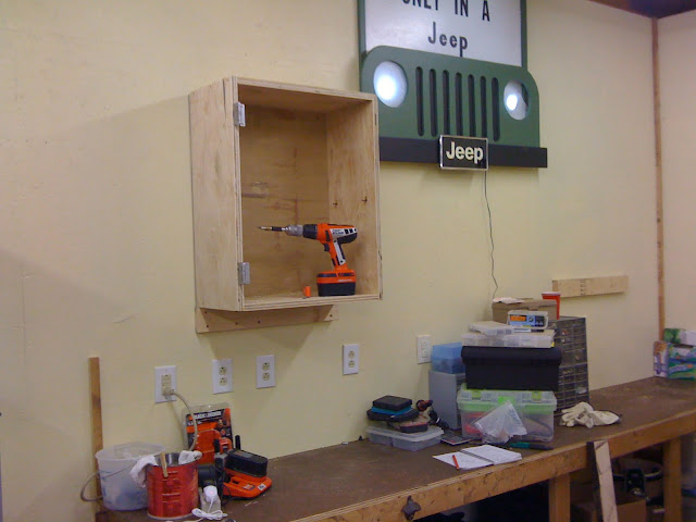

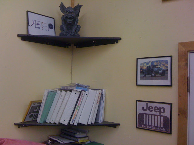

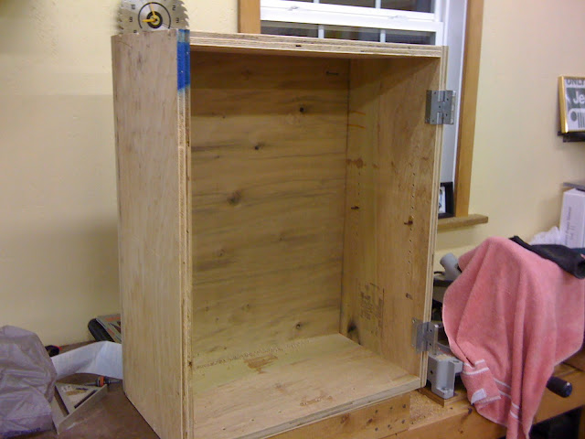

Well, I finally got around to building a few wall cabinets and adapting some corner shelves into a corner cabinet. I thought that this would make a nice build thread. Here are some photos:

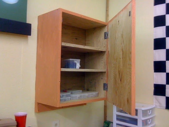

I had some guys build the shells for me. They used 1" plywood. Trust me these things will be sturdy.
I screwed them into the studs and I'll leave the 2x4 underneath to help support them.
There are two adjustable shelves.
I don't know if I like the color. I was going for a Carolina-clay color, but I don't know if that what I ended up with. It might need a second coat.

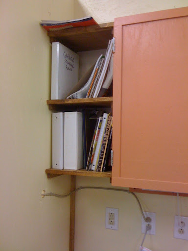

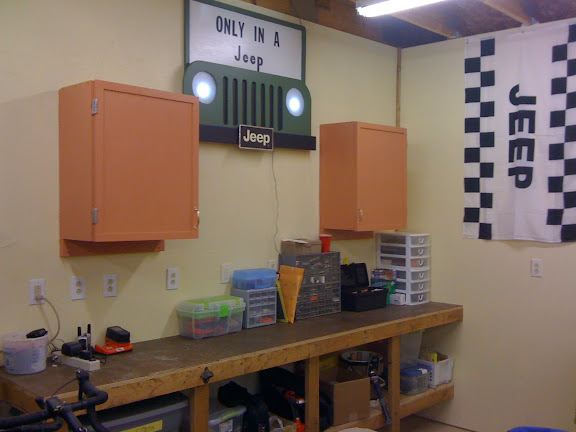

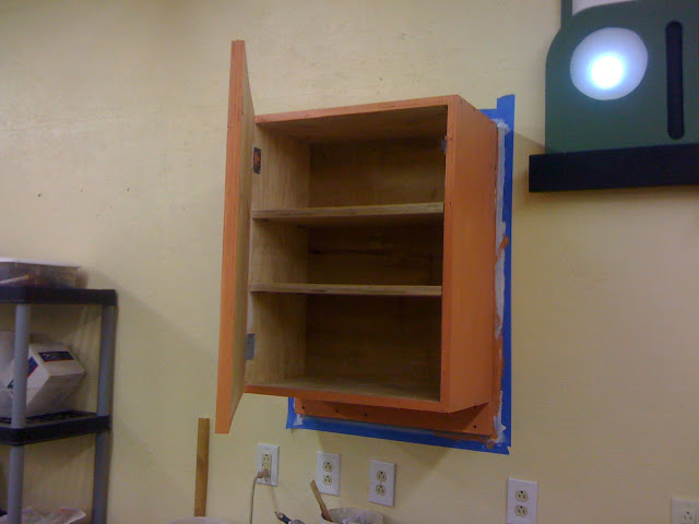

Thought that I'd add some finished shots.
Corner cabinet still nedds some adjustment
Wall cabinets done. I plan on making shels between the cabinet and the wall.

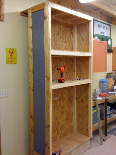

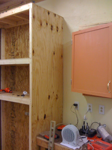

Alright, I'm now working on the big mondo - cabinet. I mean it's big! A full 4'x8'. It's 18" deep but 10" from the wall. That way I can store all my plywood behind the cabinet. I'll put doors on it and make it lockable. It will also have an open battery changing station with a power strip and LED lighting.
Here are some shots of the progress so far.
I used plexiglass on the bottom so that the plywood slides in and out.

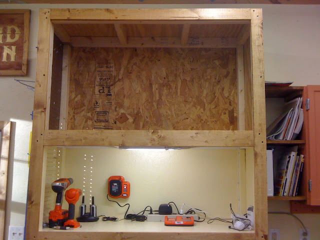

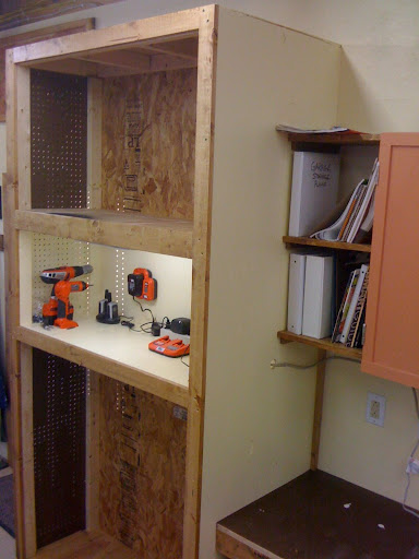

Here's a few more pix.
I've finished the trim (stained 1x4 firring strips). It still needs doors.
This is the charging station. I like the light pluged into the power strip. That way I remember to turn it off when I'm not charging anything. I also mounted a light under the wall cabinets. I wanted LED but Big Lots had a set of three independantly wired flourscents for $23.
Here I've built some open shelves between the cabinets. Ive also put some shelves between the right side wall cabinet and the other wall.

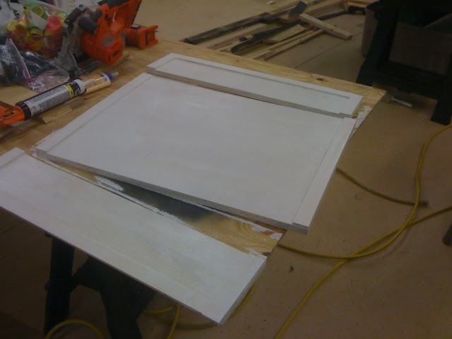

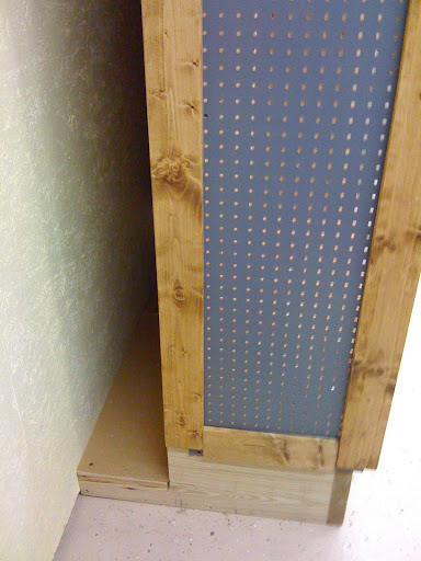

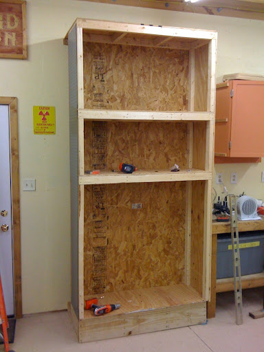

Update on some new cabinets. I'm building at least 5. Four are 32" X 16" X 72". One is a wall cabinet 32" X 32" X 16". I've decided to save some money by making the cases out of OSB and save the plywood for the doors.
I had to paint the wall cabinets above the workbench. They were suppose to be Carolina clay color but turned out salmon. Yuck! I couldn't stand it any more. I guess that all the cabinets are going to be dark sage green.
Oh, check out the new pegboard above the bench!!! I'm pretty happy the way it turned out.

I just realized that I never posted any pics with the cabinets installed.
The three bigger cabinets are spaced out about 5' for other types of storage ie bike racks, camp kitchen, shelves.
The smaller wall cabinet is mounted above a movable podium/standing desk.
