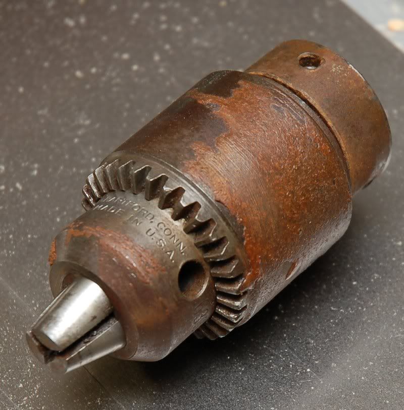

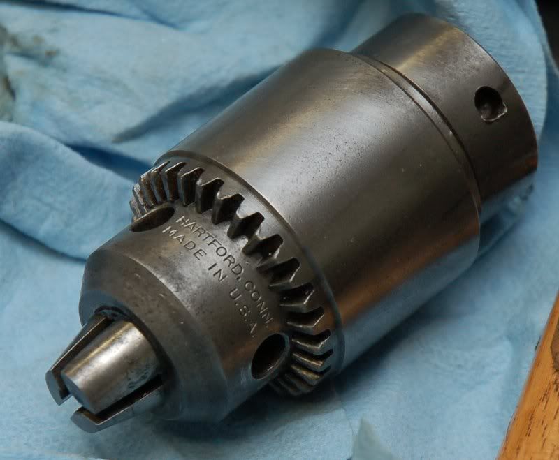

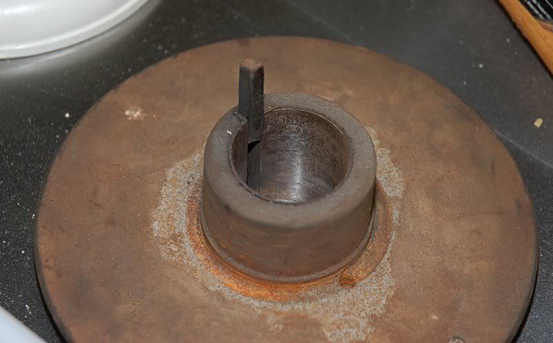

I was cleaning it up tonight and noticed that the key for the top motor pulley has been sheared off. I hope to find a replacement tomorrow and that it'll help with some of the vibration.
I did get the chuck cleaned up tonight atleast!
