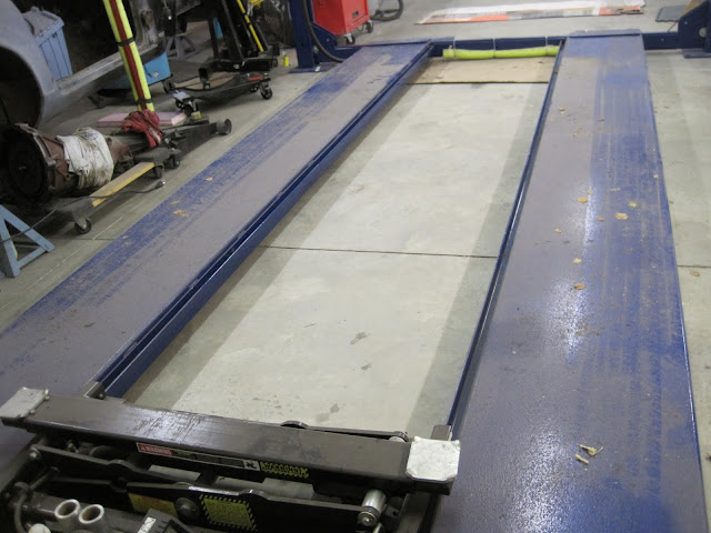

Absolutely. It has a wide and narrow setting as it is, and would likely move a little more than that. No reason you couldn't roll it on the casters with the ramp moved all the way over. I could take measures if you need them.

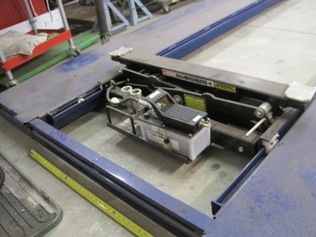

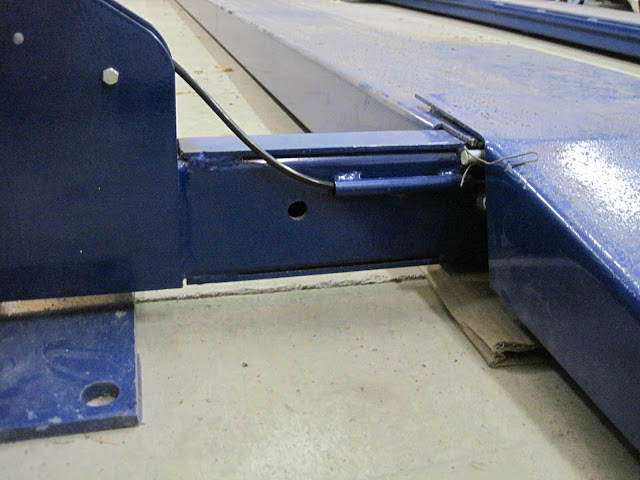

Ran out and took these for you....

I wouldn't jump into saying yes right away. The runway can obviously be moved that far over, but then the cross tube is only held upright by 2 bolts at each end (suggest you buy better bolts than the metric grade 4.x bolts they supply anyway).
Odds are you can do it, but it might get dicey. The cross tubes are only bolted to the runway with tabs. With that much of a lever arm, opposite side of the lift, I can picture things not staying as square as you would like.
Another thing I noticed is that the lift is only easy to push when the wheels are pointed in the direction you want it to go. Otherwise it takes a bunch of force to make the wheels point the right way. Figured I would mention that since it looks like you'll have some maneuvering to do.
Obviously don't do it with a very narrow car on the lift!!!

From e-teks photos, it looks like the runways are in the "narrow" position and the extra bolt hole I see in the close-up view (last photo) is for the "wide" position? I think I can just see the bolt head that is currently mounting the runway peering out from behind the ramp.
Yes slowTA, no car on the lift! And I'm sure I can get my hands on some class 8.8 or 10.8 bolts when the time comes. Thanks for that heads up.

Correct. I'm pretty sure it will slide nearly to the other ramp. which is 40inches away on narrow.

Sorry to go off topic here guys, but e-tek, can you do me a favor as well? What's the dimension from the ramp to the highest point on the RJ-45 with it lowered as much as possible? All my cars are lowered (with bodykits too) and clearance might be a problem. Thanks in advance.

It's 3" without the pedestals, 3.5 with.....I have caught the underside of a slightly lowered car, so one needs to be careful! Not sure if there's a lower profile one, or you mayneed to block low rides over the jack....maybe ask JSK!
