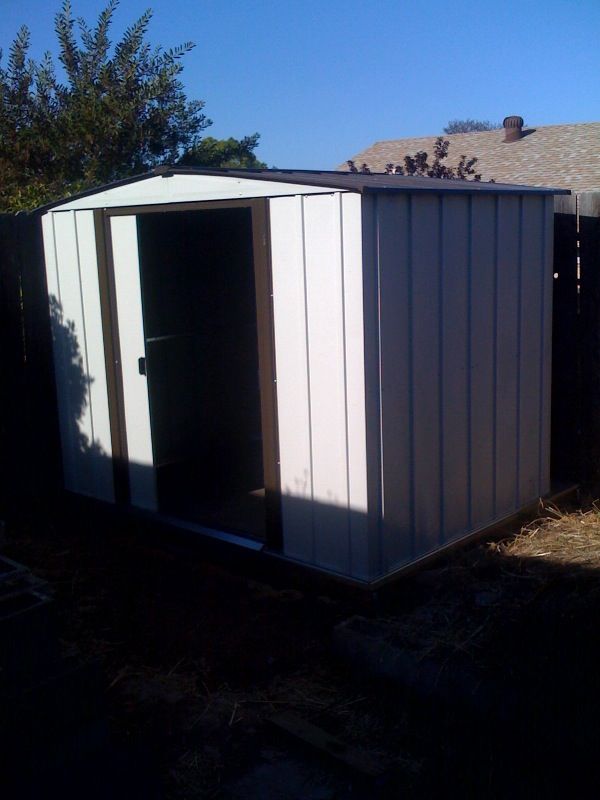

so i am in need of a shed. the wify and i found a cheap oen at HD for 200 bucks (6x8) and should work fine for what we need. the only issue is that it doesnt have a floor. it has a metal "floor kit" which you add plywood to the top, but figured it should have a better base.
do you guys think that making a frame out of 2x4s and plywood over it be strong enough for the floor? i was going to put in the ground cinder blocks for the corners to keep it off the dirt. or do i need 2x6. that just seems rather overkill for such a small shed. and yea, wile i would love a huge *** shed, budget is only around 300 for everything.

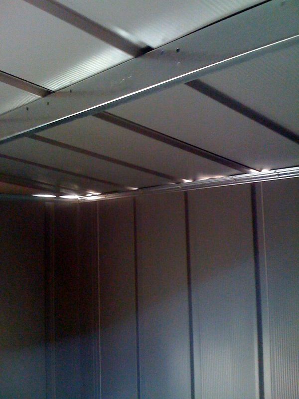

well bought some pressure treated wood and that shed. and you are right, wow, there are a lot of screws and plastic washers. took a few hours to put up along with help. and how about some pics lol.
built the base 4" extra on each side and going to maybe spray bedliner **** on it to help seal all thsoe screws.
also painted the base wood with some exterior paint that was a return at HD for 5 bucks lol. figured the extra protection would be good.
