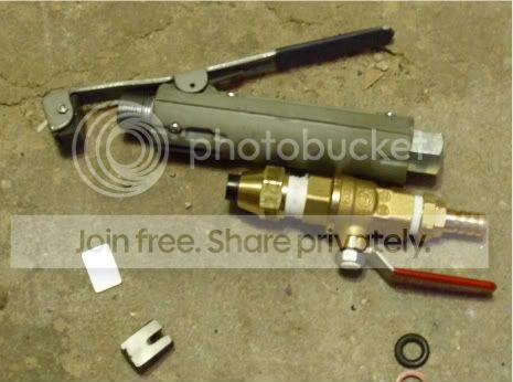

I have the 110lb pot. Works fine. Have used the heck out of it.
The first thing I did was put together a new gun:
The deadman valve blew to pieces almost instantly.
I will get almost instant clogs if the nozzle is not big enough or the media is too course. Fine sand or black diamond works fine, as long as I don't get the real course black diamond.
I open the air valve fully, and the media valve about 3/4 of the way.
The only pain is when it starts to get low on media, you have to shake the pot constantly to get the rest out. It's amazing how fast you can burn through such a big pot..
