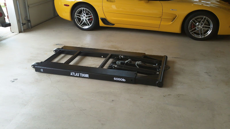

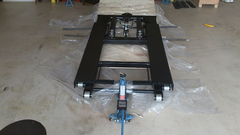

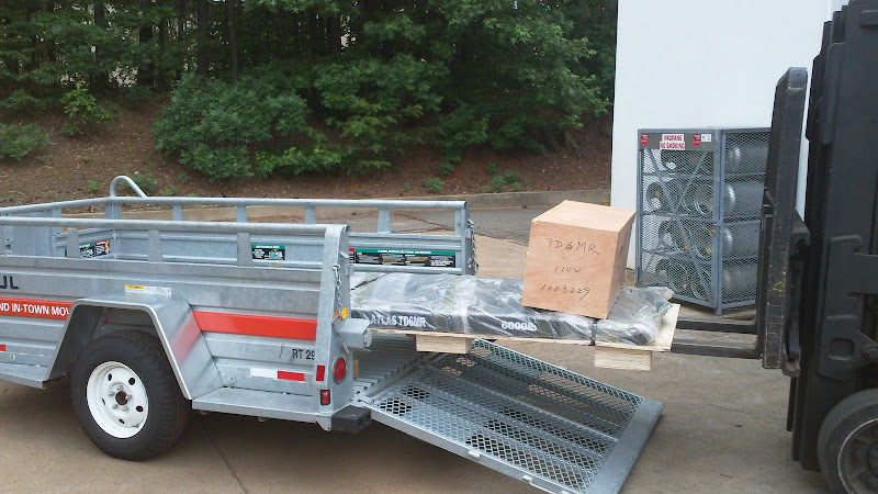

Lift transport and Unloading

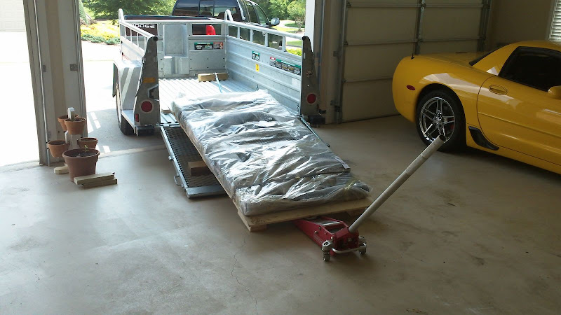

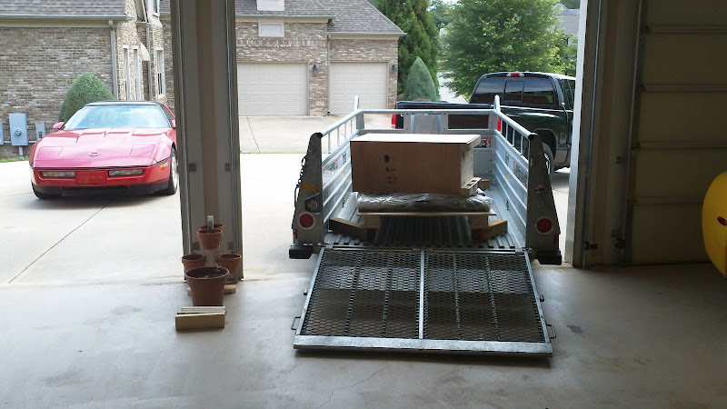

For anyone doing the transportation themselves I strongly recommend this uhual trailer, it is built really tough and the long strong ramp was key in off-loading the ramp.
One thing that help was I had it loaded onto a set of 4x4 pieces so I could get under it once I got home.
As for the unloading I used two floor jacks to move the lift just a bit at a time out of the trailer and finally to the floor. Then you realize "I've gotta get it off the pallet now!"
Best trick there was a chain on one end to lift the lift off the pallet enough to get some metal pipes under it and then roll it down the pallet to the floor.
And down!

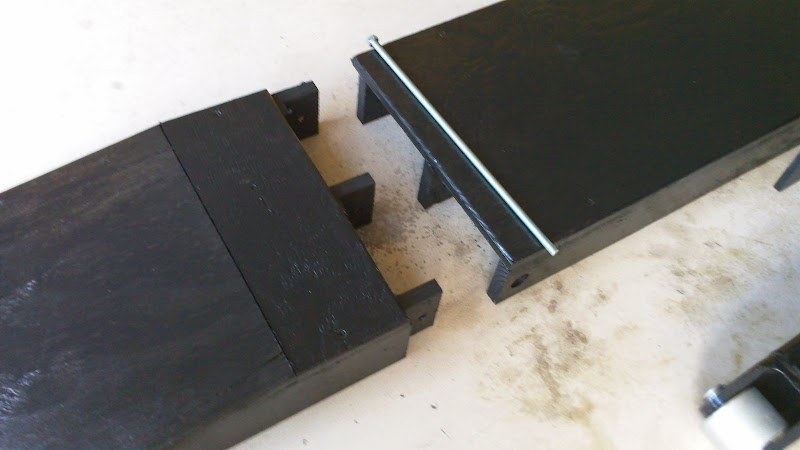

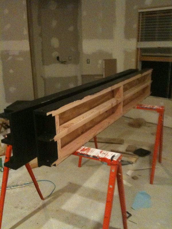

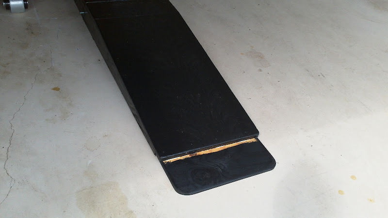

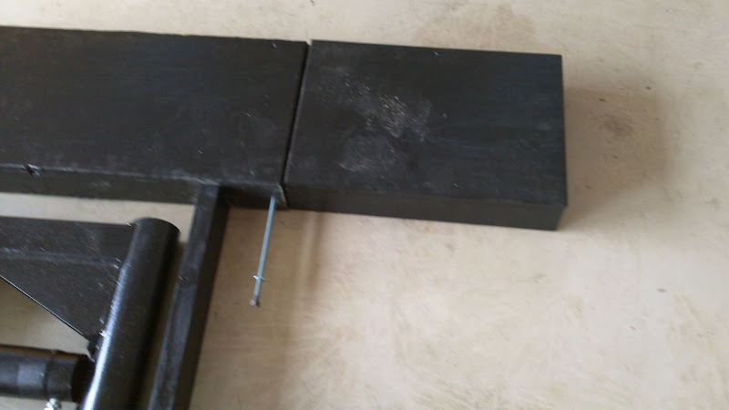

For the ramp/runways I had a different approach I want to build these to be a bit lighter than stacked 2x12's and I also wanted some flexibility to remove the front and back to allow more movement around the car when lifted.
Here is the underside of the construction
The ends are lap-notched to fit together then a piece of threaded rod with a nut welded to the end is the fastener to hold the pieces together
Ramps in place and the C4 up finally!
Had to alter the ramp front as the ramps would slide as the car hit them, so added an extension that is only 1/2" think and sloped to get the car onto the ramp and hold it in place.

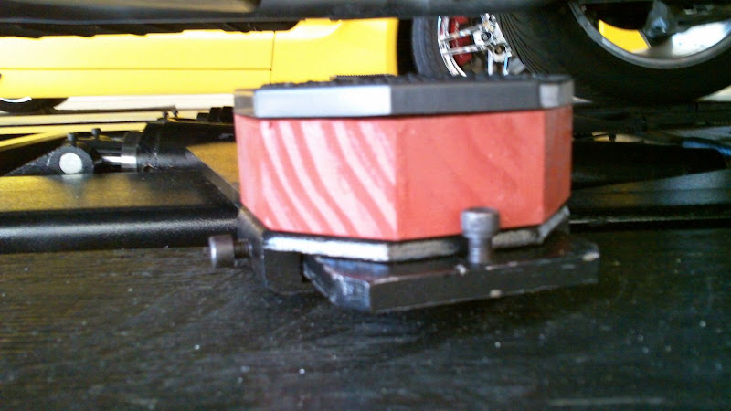

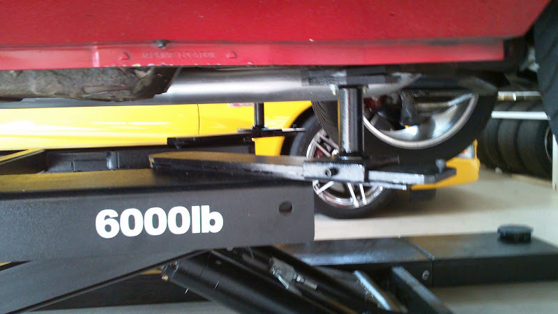

One outstanding thing is related to the lift pads, you can see here I had to use the "truck" pads to lift the C4 due to the exhaust that hangs lower than the jack points. I'd be curious if other people have a similar issue?

Nice setup. Thanks for sharing. I like your idea of making the ramps light enough to move around if need be.
Did you use 2x6's?? How thick of plywood did you go with?

Ramps are built with 2x4's that I ripped just down maybe about 1/4" to get good square sides so things would sit flush. Then put 5/8 plywood on top, the ribs are about 4 1/4" apart and the total width is about 13 3/4" The construction is all glued then nailed and screwed, they can take plenty of weight I'm sure. Realistically the ramps are overbuilt but I've got a separate wood shop and I've done some "furniture level" carpentry so I just can't help it.

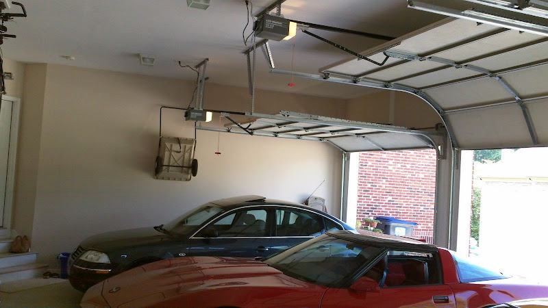

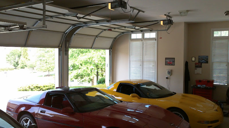

UPDATE - Doors Raised
Got the garage doors raised by a company that I felt gave me a fair price. Two guys worked about 3 1/4 hours on raising the two doors. New 32" radius track, same openers to save money. After seeing these guys work on this I'm glad I hired it out.
I now have about 10' of usable space under the track and opener. Won't be able to double stack a SUV over a vette, but two vettes, or a trailer and a vette would work fine, if I decide to add a 4 post in the future.

Do you mind if I ask how much it cost you to have the door raised? I will need to do that in my garage eventually.
I paid about $365 a door. That was with new torsion springs, new cable, larger drums, all new track that was heavier to handle the large radius that put more weight on the vertical track?
I kept looking for parts online and I found it hard to find things so given I would guess that at least $100 per door is parts I thought the price was pretty good. I think it would have been a tough job doing it myself.

Thanks for the detailed response in post #7 Dolfan, much appreciated. I'm going to follow your lead and build ramps similiar to yours.
As for raising the garage doors, was it really necessary? With low profile vettes, and the lift raising 4' max, wouldn't you have enough clearance? Or am I missing something? :)
As for adding a 4 post lift later, wouldn't you have been better off raising the doors all the way up to the ceiling? Looks like you'd gain another foot or so. Of course, you'd have an additional expense of the Liftmaster 3800 sidemount openers, but that could be offset by selling the old openers.
You're right I would have had to ad new jack shaft openers in order to get the last 5-10" of space. Right now it just wasn't worth the added $650 or so. I did need to raise the doors as I have other vehicles like my Dakota Quad Cab to put on the lift and it needed more space.
I'f I go with a 4 post it will most likely stack the two vettes, a vette and a trailer, or a vette and a FF project, or a vette and a purpose built race car. I have to many ideas as you can tell. But in all those scenarios I'll have room.

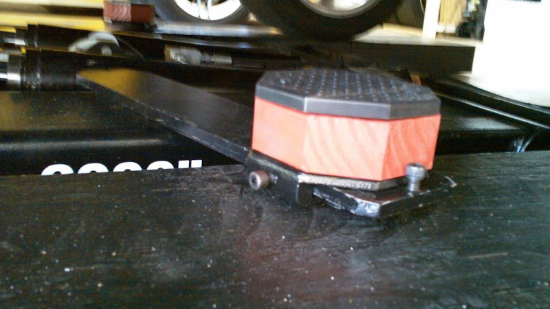

Lifting Pad Solution
As stated previously in this thread for cars with extra low points like exhaust or other items the lift can make contact first with these points before the lift contacts at the jacking points. This is when using hte "standard" pads that have only about a 1/2" rise off the arms.
My solution was a set of custom pads.
101_0086.JPG"
I used a left over 2x12 I had and traced out the hexagon shape of the lift pad, then drilled the two holes where the rubber pad is mounted to the steel plate. With new M6x50mm bolts I could now put the pads on top of the spacer and attach this to the bottom to get that height that was needed.
The idea with the paint was to paint them a color so the stand out a bit since I don't want to leave them under when loading due to their increase chance of catching something. I didn't have any "Safety Yellow" on had so the rust red color had to do.
This solution gives me an intermediate height pad between the very low original and using the tall "truck" pads.

Be careful on heavier cars. I've had wood break when jacking a car up.
I agree and was looking to do something with steel, but the fact that these pads are sitting flush on the steel plate it should work fine. I'm using this with my C4 corvette only right now and it only weighs 3350# so I think it should be fine.
If I had a more HD welder I would have built something from steel!:thumbup:
Scramblur
May 21, 2010
160
If you want cheap and safer pads, use plywood stacked and glued. It won't fall apart, quick, cheap, safe and easy.

I know a lot of Z06 owners (I'm an ex-owner) use hockey pucks with eye-bolts threaded in them to go up in to the jacking 'slots'.
78Bird
Apr 23, 2010
528
Charlotte, NC
My impression was that was a solid chunk of 4x4... Wood is extremely strong in compression like that, I'd think it would be more than strong enough for anything that the lift could safely support.
Yes, I have those for my Z06 as well, made a bunch for me and a buddy. But the C4 has different jacking points and the exhaust was right in line with the lift cross members.
With the hockey pucks on the Z06 I don't expect any issues. I haven't had it up on the lift yet, but will after my next SCCA event for some maintenance.
