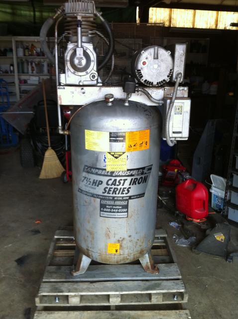

They had this bad boy:

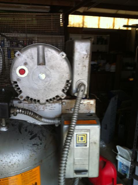

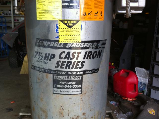

Campbell Hausfeld 80-gallon unit built in 1993. 7.5HP motor, 2-stage compressor, mag starter. 240V single-phase!
27.2 CFM @ 90 PSI, 25.1 CFM @ 175 PSI.
Delivered into my shop for $650.
I'm freakin' STOKED about this thing - WAAAAAAAAY better than the stuff I was looking at, both inside my price range, and even a ways outside it.
This shop has a fantastic reputation, they've done the PM service on the thing for the previous owner, until they traded-up to a heftier 3-phase job.
They took it in as trade, went over it and verified everything. As it's used, it's only got a 60-day warranty, but it's a pretty rock-solid unit, so I'm not worried about that!
Now all I have to do is get the work in my shop finished - cleaned up, the circuit for the compressor ran, and plumb the thing, and I'm set for air forever!

Thats a really good compressor. I had one almost identical to it in my first shop.

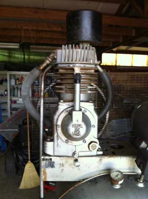

Ive never seen a single phase compressor push the numbers that one is. 27cfm from an 80 gallon compressor is amazing. The pump must be huge!
CH compressors are great. The early 90's models (like yours) where the best! The performance and price was outstanding,
But some time around the late 90's early 2000's they had Coleman build/supply their compressors and they where pure ****. They over inflated the specs, and had cheap parts like non ANSI certified tanks with 125psi max pressure rating and 115psi single Cly pumps. They only made them like that for about a year, maybe two and are real easy to spot. They all where red in color and had a huge air filter housing to make the pump look big.
Now the new CH's are much better, and still fair priced but nothing like they where between approx 1991 to 1997.
If I was in your shoes I would spend another $100 and buy a new ring and gasket kit for the pump and "brush" kit for the motor. That compressor is much too nice of a find not to rebuild. A replacement at that CFM level would be well over $1600 plus their not hard to rebuild. $100 is cheap insurance and it will last you another 17 years!

Yup, it's enormous. It and the motor are FAR larger than anything I've seen shopping around.
Thanks for the recommendation! I'll need to call the shop and verify, but I believe it's been done quite recently (within the last year or two) as part of the PM they did for the previous owner.

I have that exact same compressor, in the Husky version. Except for the paint color and the brand of motor, its the same. Motors are low bid, one week its Emerson, next week its Baldor, etc.
Good price, new about $1795 is the best you will do now. Newest compressors, the pump does not say "made in USA" (mine does) and pump and motor are reversed, allows use of shorter copper tube, saves money..............
Good compressor, little loud but good.

Its a pretty typical CFM for a 7.5HP compressor, only difference is the 3phase vs single, he just takes the bigger hit on power draw up front, probably around 30ish amps running. The pumps really arent that much bigger than one you find with your standard 5HP, they pull the CFM with high RPMs, usually around 1000-1100 for the pump which is quite high.
Great air, not the best for heat and noise or moisture. For $650 though i certainly wouldnt be complaining.

Whoa, thats a beast. If it has been recently rebuilt then it'll last a long, long time...
