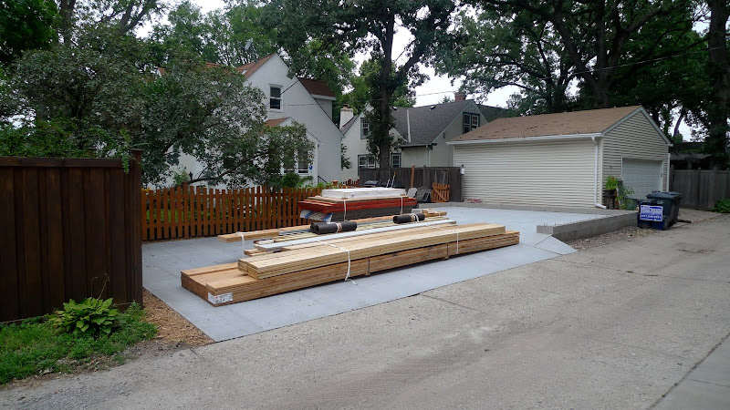

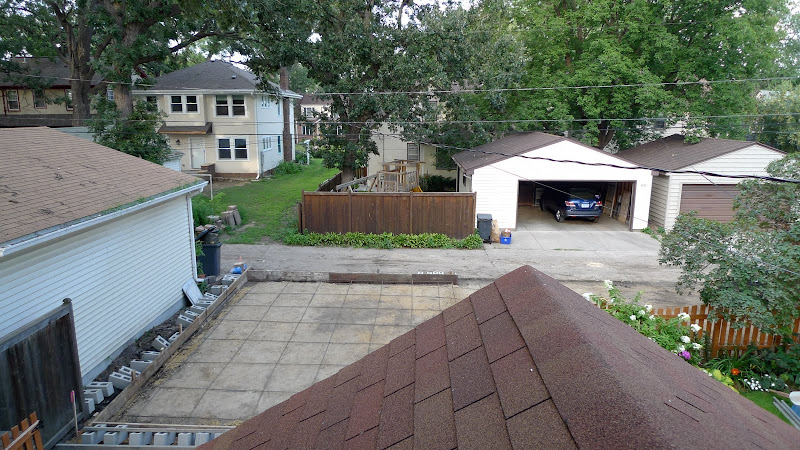

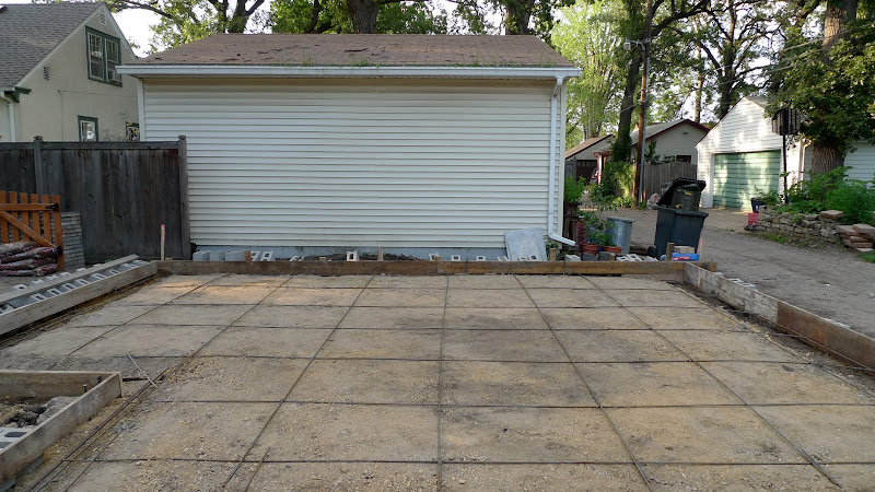

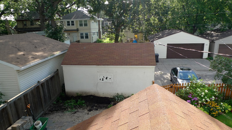

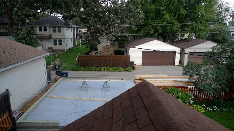

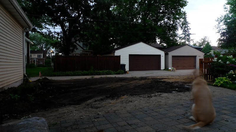

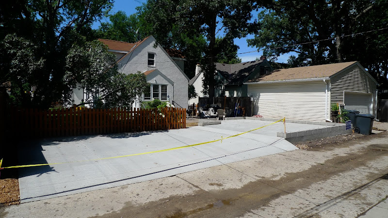

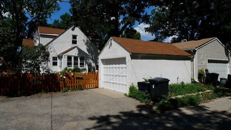

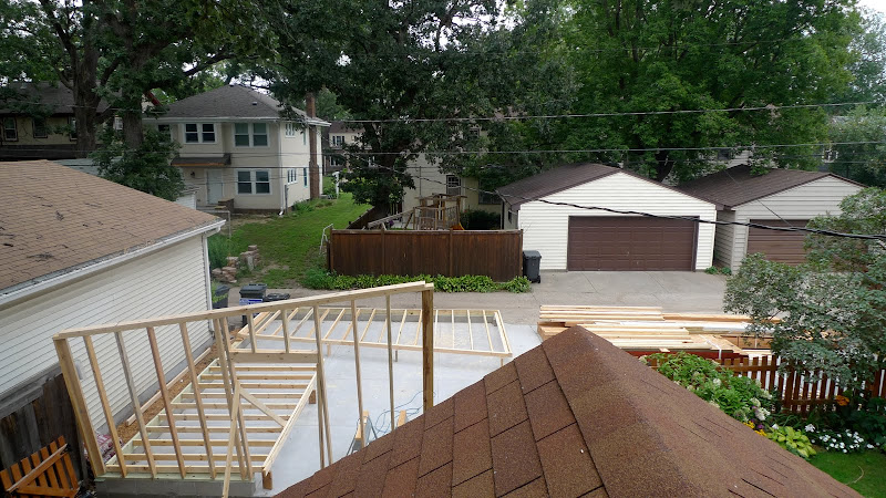

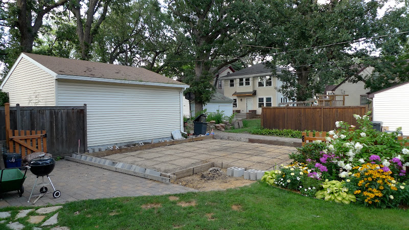

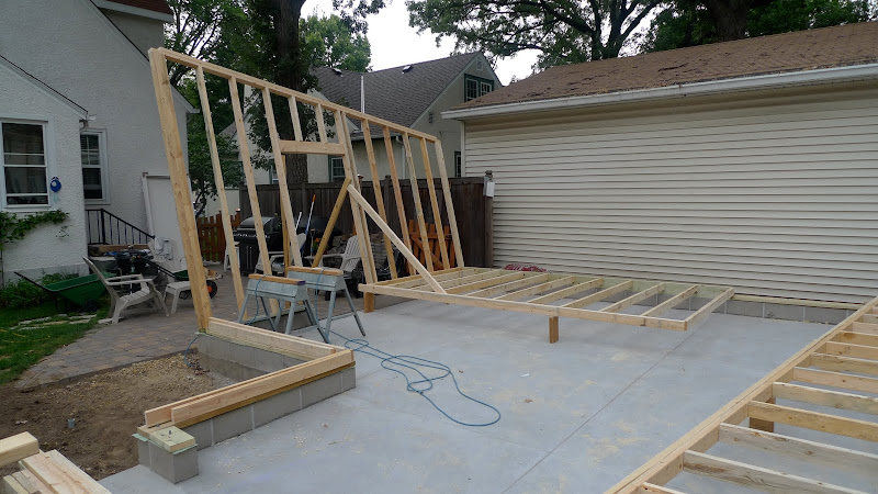

First a couple pictures of the old garage. It's a single car 12x20. We think it was built in the early 50s, house is 1929. At some point they cut some studs at the back wall to fit a 70's land yacht. It sat about 7-8' off the alley property line so we were able to add space for two car without eating up much of the yard. We decided to take a little extra as you'll see further on.

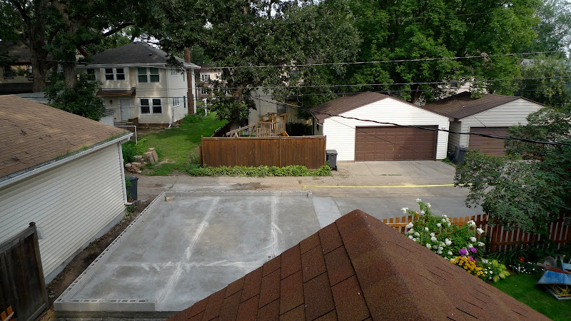

From the upstairs window. We've transplanted the small garden at the edge of the patio, hence the mud pit. It's not the best view, but makes for a nice consistent reference as the build progresses.

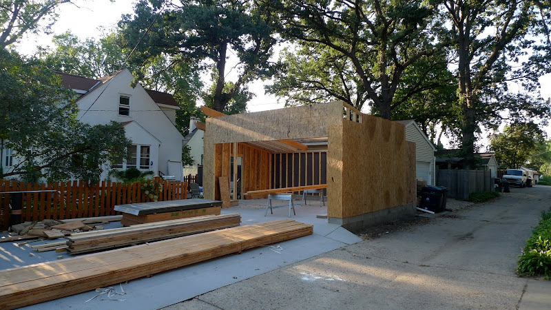

From the alley.
