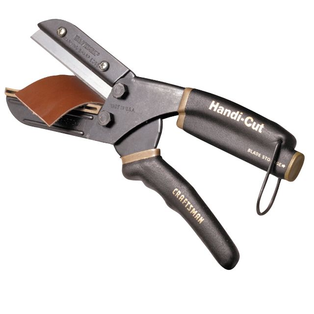

Theloniousmonk
Sep 10, 2010
1,814
Where the tall corn grows!
Pro Handi-Cut tool (similar to the Edge Cutter): PASS - mine is made in US and Pro model, don't know if they still are. Great design, works for everything that is thicker than paper, including slicing 0/1 wire.

I ordered this Handi Cut tool too. Just a little disappointed that the one I received was Chinese Made when I was expecting a USA made tool as shown on the Sears website. The tool is still ok but would have been happier to get a US made one.
I bet we paid the same price for your US Handi Cut and my Chinese Handi Cut.

The Pro Handi-Cut tool; has gone through a number of revisions: original without the integrated blade holder in the handle, different handle accents, gold, red etc. (USA), integrated blade holder (USA) and now somewhat recently, it went Chinese... The quality seems similar but it seems to be made a little "thinner, lighter" and not quite as hefty. Tell me what you guys think but that was my sense when I got a USA one, warranted and was given a Chinese as a replacement! :(
Overall, this is a great tool; I have seen it on the Snap-On truck in a different color, under the Bluepoint line.
I have the Chinese one with American blades and I give it a pass so far. Mine has the blade holder in the handle.
