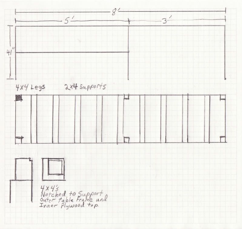

I'm ready to finally build my bench in my garage and was wondering if there's any major differences in the use of 2x4 or 2x6 lumber in regards to weight capability?
My bench will be about 8' long and between 30-45" deep(haven't decided yet) and 41" tall. I plan on using 4x4's for the legs with one span being 5' with shelving and the remaining 3' left open. And, I'll be using either 3/4" or 23/32" plywood with one layer attached inside the frame and another layer mounted over the entire frame giving me 2 layers total with 2x4 braced rails running under to add additional support. Here's a rough sketch of what I'm thinking. Please be kind, I've never had a drafting class in my life and it's not to scale.
OK, so my questions are:
Would I be better served by using 2x6 for the outer frame rails instead of 2x4's or is there little real strength differences between the two when using plain pine boards laid on the vertical?
What is the best way to attach this frame? I plan on using regular wood screws and glue with multiple screws used in each piece of wood.
Would trimming into the 4x4 legs weaken the structure? How would be the best way to brace or support the legs on the outer edge that won't have shelving?
Anything else you may see as a potential problem, please speak up. I'd like any input you have on this project. I want this bench to be able to support alot of weight as I will be using it at times to rebuild a transmission for my Bronco.

You can easily use 2x4's for it all. Double them up on the legs, and cut 1 of the doubled up ones to provide maximum support. This sort of idea:
Cheap. Easy. Strong.

I'd thought about doubling 2x4's but decided it would be stronger to use the 4x4's and route out an indentation area to attach the vertical boards for the external frame. That way the legs for the platform would be 1 solid piece and less likely to deform if a heavy load is placed on it. That's also why I want to have a double plywood layer top with bracing under it along the length of the table.

Structures of every kind are all about triangles. Imagine your workbench made of long straws. The area where they intersect is very small. If you fasten each joint with only one fastener then each joint acts as a hinge and the whole structure will act as a parallelogram and rack to the side and fall down. Even if fastened with multiple fasteners the triangulated area is small and the force it will resist is limited. Members with a larger cross section will resist more force at the connections both by allowing fasteners to be spaced further apart and by having longer faces pressing against other members. Also, a deeper member will resist bending better in the length of the bench (From loads placed on top the bench) and allow fewer supports. In other words a 2x6 is better. To get more strength use stronger wood species and pick individual boards with straight grain and few (Or no) knots or other irregularities. Take a look at how woodworkers workbenches are constructed. They are designed to resist loads from multiple directions. They use hardwoods and steel threaded rods and nuts to help the wood to resist loads. In addition they use mass in the table top to also resist loads produced during use. Triangulate wherever you can for strength. Think of the X bracing on the back and sides of steel shelving. Solid panels of plywood on the back and sides and bottom and top of cabinets provide triangulation when properly fastened along edges.

I'll second zengineer on sistering two 2x4 vs one 4x4. If you want to route, chisel, etc, then 4x4 is a good way to go. But, for a functional bench made of construction lumber, it'll go together quicker w/ 2x4's sistered. Glue 'em up and it'll be as strong / stronger than the 4x4?
edit: for my garage, i copied family handymans best workbench. I used 3/4" plywood for the top. It seems pretty darn strong / stable. Hindsight, i'd use spacers/blocking to get the front and back rails spaced exactly the same for drawer fitting reasons.

Another question on Assembly. I've got plenty of varying length wood screws and figure on drilling and securing in multiple points. But, would it be beneficial to also use something like 3/8 Lag bolts and washers on the 2x6-4x4 attachments?
I've decided on using the 2x6 for the outer top frame and 2x4 mounted either every 12 or 16 inches inside the frame with 3/4" or 23/32" plywood. I want to have the top overhang from the frame but I'm not sure what would really be the most functional length. I don't know if 4" is too little or 8" is too much. I want to have the capability to mount things under in the future. I had seen the Receiver mount before when I first started looking at ideas and liked it as well. I can't find that thread now but I'll keep looking.

I see this bench as a do everything hold anything bench. I'll be setting my transmission on it when I tear it down to rebuild in the coming months. I've decided at 41" height, my 6'3" body is comfortable working at that level and I can sit at it with a bar stool style seat and comfortably use it to work on radio, do some reloading at times, tool repair, home maintenance, restore my Cushman scooters, and pretty much anything else that comes my way.
This is what I envision for the bench. So please keep the impressions coming. I'm taking the ideas in and seeing how I can modify my idea to incorporate them as I think they'll improve it.

Go with two shorter benches. Years ago I made three 24" X 48" X 30" (ht) benches with 4X4 legs. The stringers were 2X3 (ripped down 2X6) and put them together with 3" wood screws. The tops were all 3/4 CDX plywood. They have held up well through the years and I have abused them a LOT. I have no qualms about standing on them, putting my toolboxes on them, transmissions, engines, or anything else. Heck one time I seriously considered putting a car on top of them. If I'd had four of them I probably would have.
The reason for the multiple smaller benches is you can change configurations in your shop easier. That 8 foot bench looks like the thing to do now but later you will probably want to move it to another location.
Also make a two or three inch overhang for the top. You will eventually want to clamp something to the top and if you are flush with the bracing you have to have a minimum of a 4" clamp.
X2 on the receivers for vices and bench grinders. It lets you use the whole bench when you need it. It's also fun to see the look on your friends faces when they see the vice off of the bench and you go put it on the back of your truck.

I'm looking at what you built and it is a good general purpose light to medium duty bench. If what you want to use it for was similar to the OP wanted, I would do a couple of things to make sure I could put a trans or even an engine on it. First, I would put a sheet of 1/2" or thicker plywood on the back and ends. This will brace it from folding up. Right now only nails resist this. I've seen sawhorses with a lot more nails than you have, fold up when a large weight and a small lateral force were applied to them. I was part of the weight and you should have seen the surprised look on our faces as we tried to install a beam in a pocket and the 4 sawhorses collapsed beneath us. Very lucky no one was hurt as the beam fell. The nails holding the sawhorses together pulled out from a very small lateral (Sideways) force as if they were being pulled out by a cats paw. Nails have no strength in this direction.
So the solution to resist lateral force is to triangulate the bench in both directions with a panel of plywood fastened with screws or nails @ 6"o.c.
The second thing is the load placed vertically on the table. If this is a large load like a trans or an engine you need to support it properly. The first thing resisting this load is the plywood top. This acts as a beam between the 2x4 supports. A transmission will create a couple of point loads because it's bottom isn't flat. Make sure you have adequate thickness to resist this. Also think about the wear surface. This can be sacrificial like hardboard or permanent like metal. In any case, the plywood should be glued and fastened ofter, say 6"o.c.
The next thing to consider is what supports the top. There is direct support from the top of the legs where the plywood top rests directly on them. But the top also rests on a 2x4 framework. This is fastened to the legs by nails. These are in shear. This is not as strong`as a bolted connection and is a weak point in the design. If you had used the method of letting the 2x4's into the legs, they would rest on the legs and be much stronger. An alternative would be to use some 1/4" lag screws countersunk in the face of the 2x4 top frame and into the legs and top frame cross members. There is a good opportunity to run a lag bolt through the 2x4's that are on each side of the legs (And through the leg as well) and create one rigid assembly. Nails are OK for supporting the bottom shelf.
Follow these suggestions and for a couple pieces of plywood and some bolts and screws and nails you will have a table built like a tank and capable of supporting anything you can put on it.
