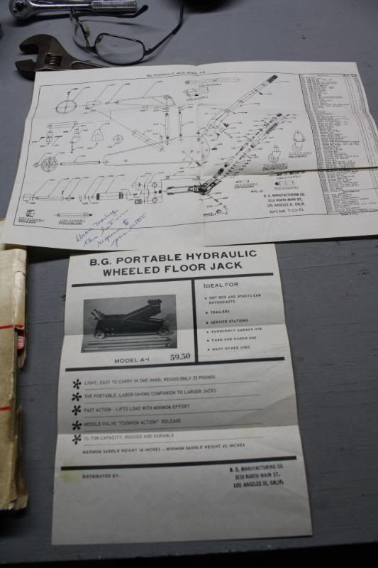

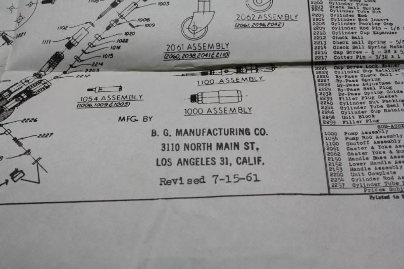

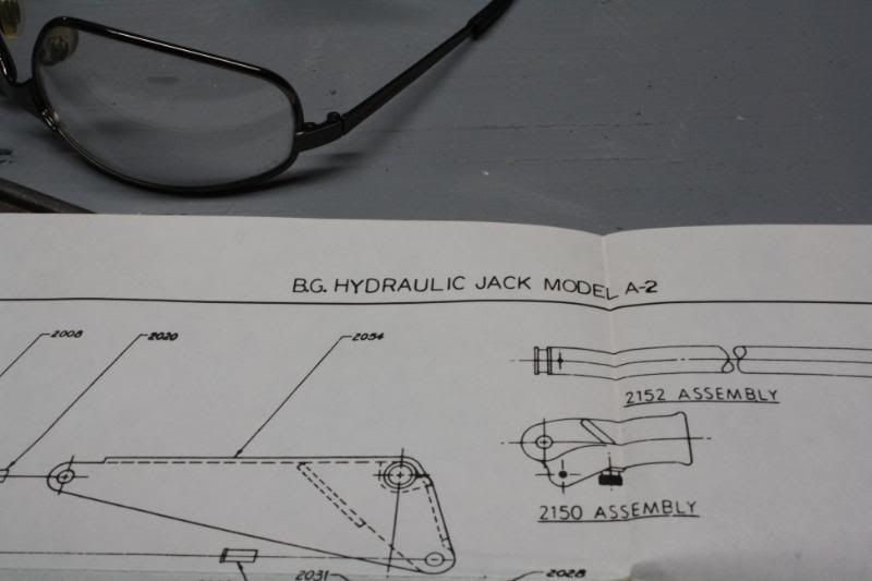

I picked up a complete Blackhawk Repair Parts Manual from 1961. It contains exploded diagrams, parts lists, and photos for the entire line of bottle jacks, trans jacks, end lifts, service jacks, and the Porto-Power stuff. Heck, it even has the fluorescent ship light that I picked up last month. With an S-4 that needs a rebuild and is missing parts, this is invaluable to me. Even if I didn't have that jack, as a collector of the brand, this is one of the best things I will ever find. I am going to try to scan the entire document, properly, so I can share sections that people rebuilding these pieces of equipment need. That is going to take some time, though.
In the meanwhile, I'm so excited I had to take some pics to show people what I am talking about.
There were a few loose pieces of paper inside the manual, two of which are for jacks from a company I have never heard of. I have a few pics below.
Thanks for looking.

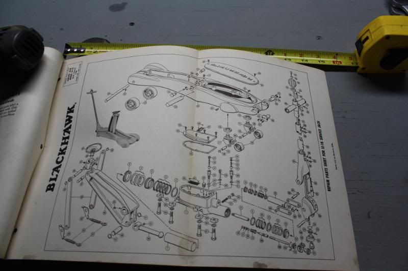

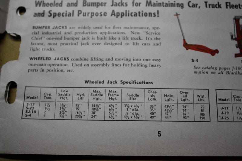

I am going to add some pics below of a catalog I just received today. It is thin, but in excellent condition and shows many (not all, I don't believe) of the Blackhawk offerings for 1956 or so.
The question of how much an S-4 jack weighs has come up here before, and people have given estimates. According to the company, it weighs 190lbs.

I knew the S-4 was heavy, and as I've said before it's definitely every bit of 150 lbs but I never would have guessed 190lbs!!
Bull, can you tell me if the S-23 in the pic has a smooth lifting arm (without a casted Blackhawk script) and a square saddle?
It would be nice to be able to give this new GJ member a positive I.D. for his jack. Thanks.

Can you post a pic of the area of your jack from which parts are missing? Or draw an arrow/arrows to these parts in the pic above?
B
Bull
Dec 12, 2005
16,189
Actually, let's see if these pics help. Your jack is probably newer than my manual; not sure if the parts changed much, but let's see.

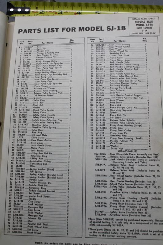

Hi Everyone, I inherited a SJ-18 from Old Jacks for some work on his house. I need to fix the rod in the picture. It needs to be cut down a 1/4" or so? it is out of another jack. It is the same part , just to long.
@ Bull I am going to ask you to make a copy of the SJ18 page please. I will post that thing up tomorrow.
The release valve control rod in the picture looks to have a universal joint. This jack utilizes a set of crown gears. If the original control rod is broken, can't you just remove it and measure what you need?
