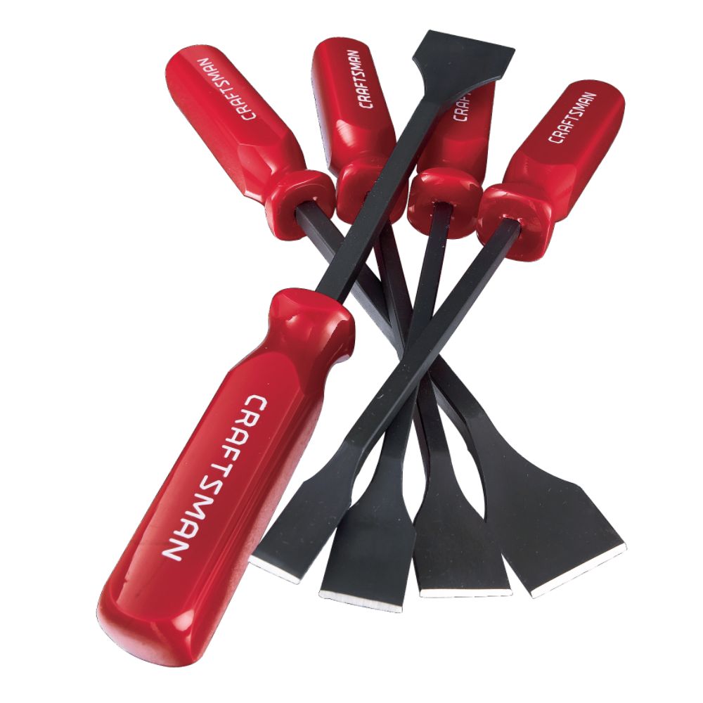

I was actually thinking that the handles on a Craftsman pry bars or scrapers would look nice on a ratchet.
