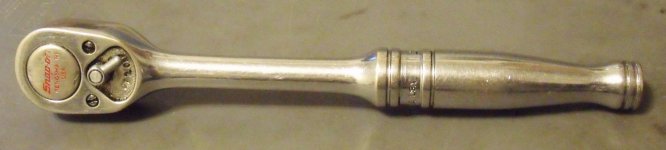

Does any body make a 1/2" ratchet in 3/8 body ? I have seen and want a Wright 3430. Is there a similar ratchet in 1/2"? Thanks

Snap-on has the SKF80. With the RKRS80 rebuild kit, I would imagine you could use that kit in most of the 3/8 ratchets to make just about anything.

Snap On and Mac both sold them years ago but they are discontinued now.
The SKF80 ratchet you were recomended is not a conversion ( 1/2" in a 3/8" body ) ratchet.
It is a short flex in 1/2" drive.
If you look at the specs listed is has the same dimensions as any other 1/2" drive ratchet 3/4" DEEP X 1 5/8" WIDE.
The 3/8" drive ratchets are 9/16" DEEP X 1 1/4" WIDE
The RKRS80 rebuild kit you were recomended is simply the rebuild kit for all the 1/2" drive Dual 80 ratchets and will definately not fit in anything else.

Snap on made a 1/2 in a 3/8 body the SF730. It is not an easy one to find though. They may have made an 800 series I'm not sure.
Here is one with a 3/8 in a 1/4 body (FM70).

I have a Snap On SF730A. It's a 3/8 drive ratchet with 1/2 inch square drive. I also have a 936 1/4 inch drive body with a sealed 36 tooth 3/8 drive sqaure drive. I don't believe Snap On makes this any more but I can still get the guts for it. It has a 1992 date stamp. That's an old MATCO BR8/Wright ratchet next to the Snappy. Same year.

But for those interested in converting a regular 3/8" ratchet to the SF730A spec, you can use about any of the non-sealed 3/8 drive handles such as the F720A, F730A, etc. Basically anything that would normally use the RKRAF730 repair kit can be converted.
You will need to order the RKRASF730 kit ($10 from Snap-on), which is the rebuild kit for the SF730A ratchet. The only issue is that the RKRASF730 kit does NOT include the cover plate. You will need to have the bore in your donor ratchet's cover plate increased in size to accommodate the larger gear. The 3/8" gear has approximately a 1/2" diameter bore. The 1/2" gear will require approximately a 5/8" bore. The cover plate is case hardened and will have to be machined on a mill to get through it.
If you are doing the conversion on a 20 tooth ratchet (e.g. F720A), you will have to do a full rebuild and replace the pawl as well, as the SF730A gear is a 30 tooth gear.
If you screw up and ruin the cover plate, you can order the RKRAF730 kit (also $10) and get another cover plate to try your luck.
Here is a photo of the conversion I did to my F720A
