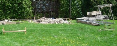

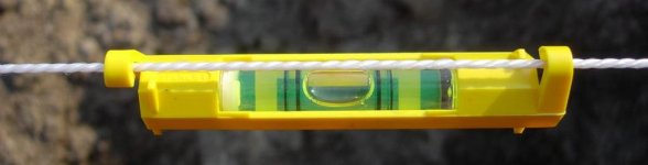

I have been lurking and absorbing infos on this forum for a while now. The 3 millions re-bar carpet machine that I was working on have been returned to Italy and as an operator/mechanic, I have been laid off. So UI is paying me now and while I check for a nice job, I get some free time to build myself a garage. Since time is the main DIY factor, let's not pass on this. I'll figure out the money aspect later.
So cutting the cost is the main factor here since the income is quite low, but so far I think I did a good job of going around the big cost.

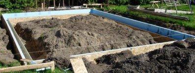

Damaged foam boards, junk concrete filling, almost free re-bars, cheap gravel, flood and 8 bucks compacting rod, used thermofoil and a bunch of drunken helpers to pour concrete.
Here the frost line is at least 4 feets, so to cut on the cost of the machinery and concrete, I opted for the FPSF system, witch is an insulated slab system that fools the footing to be in a warmer aera by placing a L shaped foam underground that redirect the frost away from the slab.
The garage dimensions are 16 wide x 24 deep x 10 high+8"per foot homemade trusses.

No trailers were harmed during this build.
I flooded the center and hitted it as hard as I could while the water was draining, it took 30 minutes before the ground swallowed all the water, good thing because there will be no drain.

Lol, I have to admit that it's confusing. Someone suggested to bring a water tanker (140$) to flood my work because it was too thick to compact already, I had to find a cheaper way (free). I just used the trailer to flood the whole gravel and sand to help for compaction. I had 2500 liters of water that I dumped within 20 minutes.
The axe was a weight attached to the hose to keep it on the bottom.
I let the trailer load on the axle (first 1000 liters) then I jacked the four corners so it won't break. I tried to flood with 2 garden hoses, no way, the ground drink water too fast (sand). While flooding, I gave her a good shot of my homemade compactor and gained half an inch, feels solid now.
I plan to pour the concrete slab Thursday, I attached the re-bars, need to place the radiant heating hoses, it start looking like the real thing. So far I have close to 500 $ spent, but I had 400 $ re-bars for almost free, I have built a couple walls, in exchange they stoked me with 288 pounds of 10mm bars.
