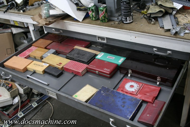

Oh sure. Last fall I picked up a kind of beat-up set of Cole map drawers. As noted, they're not full-extension, and were almost a foot deeper than my workbench was wide.
I ended up removing the individual drawers from the outer cabinet (which was damaged anyway) and cutting them down with the plaz. I had the local metal shop shear me some strips of 20-ga and welded them on the cut end, to make full drawers again.
Then I made my own frame to screw under the workbench, that held ball-bearing drawer slides from Home Despot:
Loaded weight hasn't been a problem. I have one drawer chock full of my measuring tools and indicators, and I doubt I'm anywhere near the capacity of either the slides or floor of the drawer.
You might start stressing a full-size drawer (remember, mine were narrowed somewhat) if, say, you stacked it full of loose sockets, or piled it deep with three layers of wrenches. But if you load it like a lot of people do their Snap-On drawers (like those foam inserts that keep the tools separated) I doubt you'd have any problem at all.
I've been hoping to find a second set, hopefully matching, to run the drawers all the way to the floor. They're very handy, and often even more useful than a conventional toolbox drawer.
