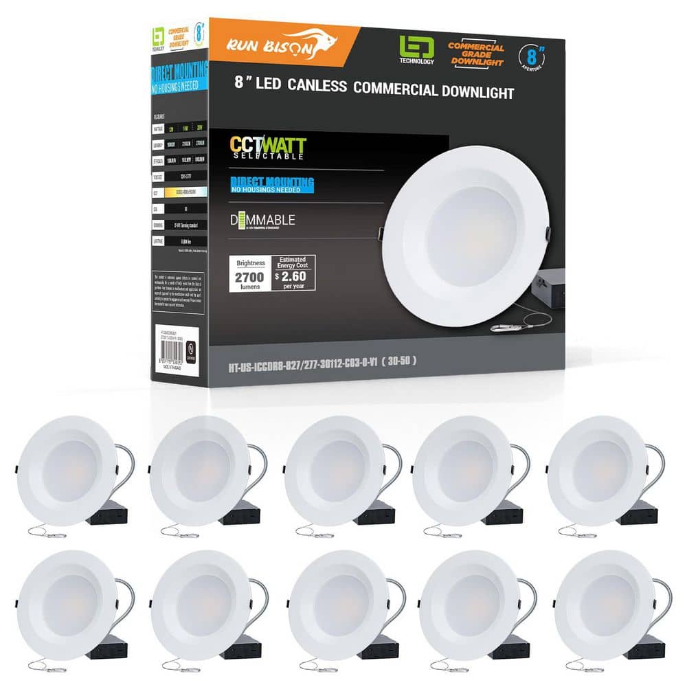

I have designed my shop to have a work area under my loft and it only has an 8' ceiling. I'll have cabinets down the long side, a work bench, lathe, mill, and welding table under it. Due to the low ceiling (and I like the look), I want to run can lights. Tentatively planning on 16x can lights (8" dia) in a 32" x 48" grid under my 10' x 24' loft. On a scale of 1-10, how bad of an idea is this? I'll have task lights on the lathe and mill, and have excellent lighting in the rest of the shop, FYI. Any thoughts or recommendations on lights?
I was planning on using these:

With 10 being the worst, you're at about an 8.
Those are commercial downlights, at 2700 lumens each in the highest setting. Too much for an 8' ceiling and a 3' work plane. Those are designed to have a beam for a ceiling of about 12', which will be too tight for an 8' ceiling, in other words, you wont get good, even coverage. Your spacing is also too close to the cabinets. Finally, they'll get dirty, and they're a pain to clean, and there's 16 of them.
Get some integrated LED strips lights and surface mount them. There are dozens of styles out there and they're really small these days. You should be easily able to find them that are between 1" and 3" deep and 4' long. Move them forward, away from the cabinets about 24".

I have a Lithonia 4000 lm CPANL over my workbench in the garage area where the ceiling is 8’. It provides great light. I used the higher output 6000 lm units with an 11’ ceiling. I stayed with a reputable manufacturer.
And I agree the cans are the wrong choice.

When I renovated my basement with 7' (or a little under) ceilings, I went with a similar spacing, though I used 6" round flat panel lights. I needed such tight spacing with so many lights to avoid dark areas between the lights. The down-side is that the light output of cans is designed for high ceilings and larger spacing, so now you have twice as many lights as expected. I got around this by using dimmers in every room that were pre-set to stop at 40% in the bedroom and 60% elsewhere except the kitchen. At 100% in the kitchen, you're at full on task lighting levels everywhere.
The 8" lights you chose are going to be VERY bright at that spacing (and you'll get light and dark zones if you use half as many). I suspect you could get away with 6" flat cans and still not need task lighting. Or install the 8" with dimmers and wear sunglasses.

Add these to your research. Having the disk recessed like these can reduce glare. I researched 6" and 8" disks for my shop. But in order to get the light levels I wanted it required too many disks.

This is important. Assuming top cabinets are 12 to 16" deep, lights will need to be much closer to the center of the room than your drawing shows. If you are mocking things up, try adding a cardboard box on the wall to represent the cabinets.
