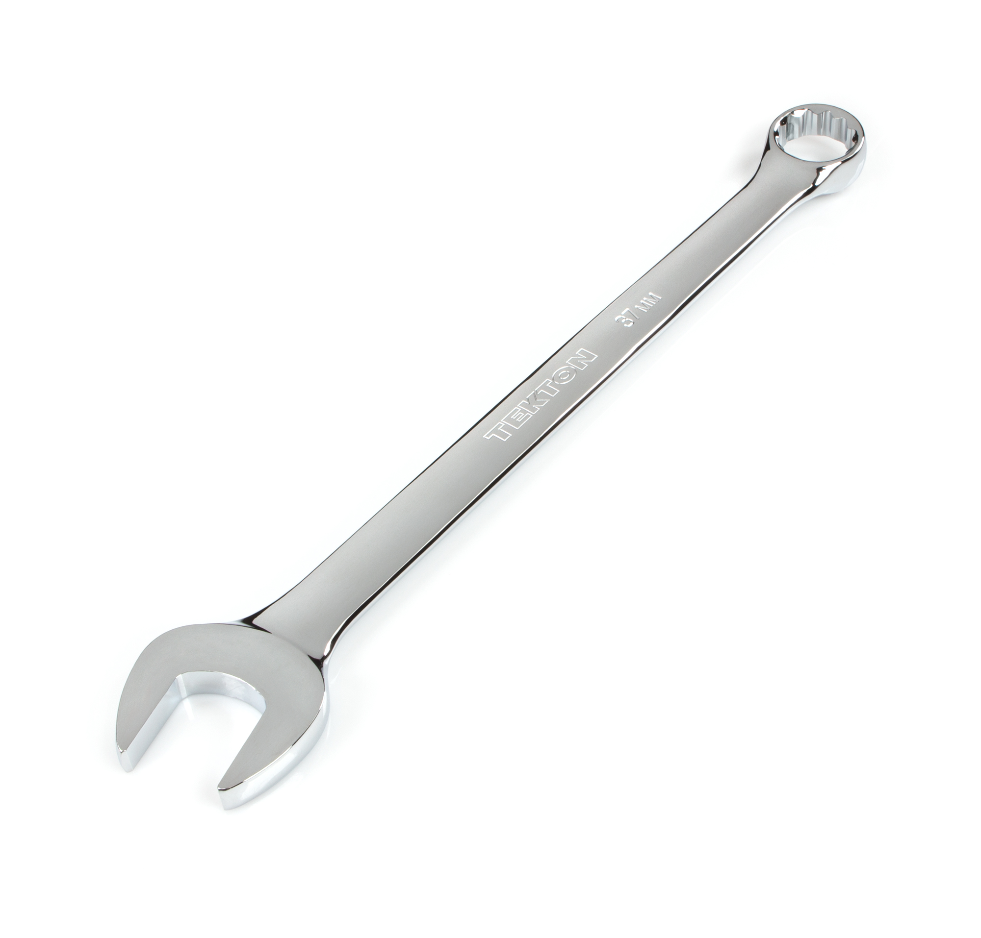

Here's a screenshot of the Proto catalog, page 583 of the 2024 PDF catalog:
This is the Proto 37mm wrench on Zoro for $50:
The proto has a listed head thickness of 9/32" or 0.28"
The Tekton wrench is $44
The proto wrench is 0.57" thick which is twice as thick as the Proto.
The proto wrench is Made in the US, the Tekton is made in China. If you get a 20% off Coupon at Zoro when comparing the Proto to Tekton, they will be the same price (about $40) after Tekton 10% rewards.
I would have guessed the Tekton might have been half the price and suggested grinding the tip down, but that doesnt appear to be the case.
