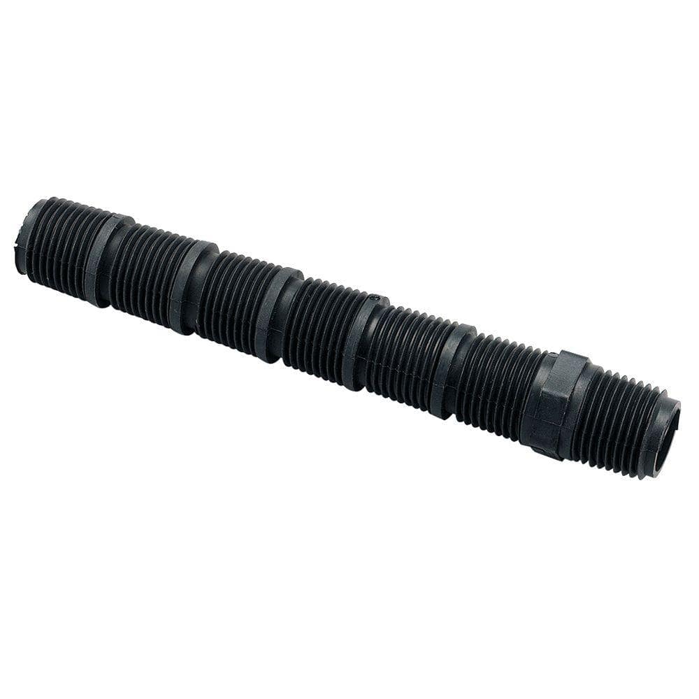

Your best bet would be a plastic pipe ******. A 1/2" poly sprinkler riser usually has a wrench hex, so I'd choose that over schedule 80 PVC. 35 cents sound good? This one can be cut to it's shortest length, but short ones are often in a bin next to these.

I have used a poly NPT pipe ****** and the rubber gaskets, worked just fine.

Just reporting back - sorry it's taken so long but life happened. Anyway, I never thought about a sprinkler riser - thanx for that tip. I snagged one of these schedule 80 PVC from HD:
a whole 47 cents, shipped free so I didn't even have to go to the store, and I didn't have to cut it. Put a rubber washer on each end and the hoses screwed right on. They're both right-hand thread but they screw on the connector in opposite directions relative to each other, so getting them tight without a hex was no problem. Now I have a 10-foot shower hose that doesn't leak and can reach every single part of me, leaving no part untouched. :ROFLMAO:
