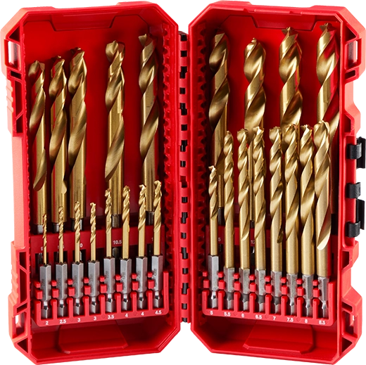

c32b440c1fcb4d96b635124d5061223e
https://www.milwaukeetool.com/products/48-89-4861
BillK
Aug 24, 2006
9,428
Beautiful Southern Maryland
I might be wrong but it looks to me like those bits would never run as true as a normal bit. Not really sure what the reason would be to ever use them ?
