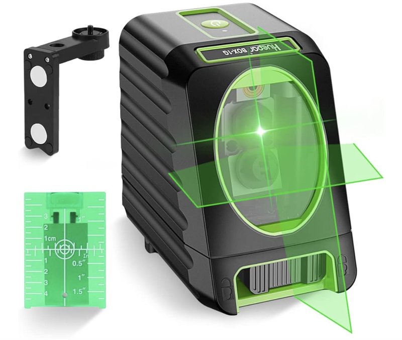

I have a Mohawk System 1. It can lift anything but it only comes with regular 2 stage arms.
For smaller cars like my 53 Willy’s Jeep or my wife’s Honda the vehicle has to be at or near the perfect spot for the lift pads to be set properly with the lift arms fully retracted. The Willy’s only has one spot that works and sometimes Ive had to use pump up wheel dolly’s to move the vehicle a few inches to that one spot. Three stage arms that retract more would do away with this problem.
I actually set up an inexpensive cross line laser in front of the lift to shoot a vertical line right down the center of the lift so I can nail the left and right every time and only need to roll small cars back and forth to get it to the sweet spot.
