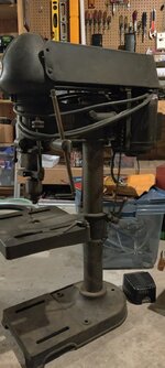

Wanted to share a few pictures of my 1940 Delta DP220. It's taken me several weeks to get to this point, the Delta repulsion motor is still getting worked over.

Slow speed version as well! Great job! I've got the same machine. How are you gonna keep all that metal shiny? ;0)

Can you share what about the DP indicated it was a Slo-Speed model without you seeing the pulley? Ive been looking at it and wondering. And yes, it does have that slo speed pulley!

It's got 5 raised "bands" on the front belt guard. The fast speed DP has 4 raised bands. I didn't know that until I bought a rear guard off ebay and it was obviously not the correct part. The good folks on OWWM (Old WoodWorking Machines) pointed out what was what. FWIW the slow speed is a bit rarer than the fast speed per the OWWM folks.

Yeah I went on the VM photo index for Delta and noticed that it's not just the five raised bands vs four.
Every slow speed 220 had the flatter type front pulley cover that I have, whereas the "four band" pulley covers were taller and more conical or pointy (I attached an example). I'm sure this is a styling byproduct of the fact that the slow speed pulley has a very large sheave on the bottom. Either way it's an awesome factoid.

Yeah. I didn't think to share those feature differences. I really like the look of mine with the rear belt guard in place.
When was yours manufactured?

I have an aluminum serial number plate No. 8-5351. I had checked VM to date it, and can't determine. My most logical guess is 1940.

Nice job Hoorn,
I like the color you picked and you did a great job on the details, nice restore. The table looks like it's in great shape and no inherited Arc of Shame. I've done total rebuilds on Delta induction motors, you'll love it when its all said and done; tons of torque.
Looking forward to see it complete and how you choose the power switch set up.

I decided to keep the orig. paint and patina as its wasn't quite bad enough to let it go and also did a couple of mods that takes it way from its original classic look, although I did decide to keep the old orig cardboard tube on the column floating above the table to help protect the column from banging things into it and rust. I noticed this was done in some of the old pics I found.
I will say that the vintage repulsion induction motor is comically stronger than what motors are currently rated today at same HP, they're so nice to have. I was recently forced to put it through its paces to put a bunch of large holes in thick steel and did an awesome job. They're great little DP's
You're going to be really happy with your DP220 when it's up and running. One suggestion while waiting for the motor to be rebuilt is to check the runout below the chuck jaws with a dial indicator. Mine ended up being .0025" so I was pretty happy and left the bearings and chuck alone, no point of fixing something that's not broken. However, I've had quite of few of the 220's that needed some help with runout.
