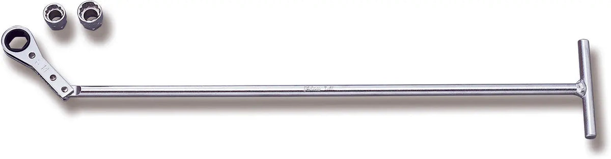

Are there any such thing as low profile (nanoish) 12 point sockets? Specifically metric? Been trying to find a good solution for doing turbos on ISBs in chassis. I keep destroying the flex head on my Craftsman V series long ratchet wrenches (the tank on the flex head keeps bending), replacing it is impossible and repairing it is a pain to do every job.
Snap On seems to be the only set that I've been able to find that are currently available. I've found that OEM tools has, or at least had a set, but seem to be unobtanium. I don't mind paying the Snap On price, but I just wanted to see if anyone had any ideas for other options.

Koken makes handful of 12pt sockets that are ~3/4” tall:
I’m not sure if they have a square drive end for a ratchet though. Seems like they are just for their “ 154K Push/Pull 6 pt. Ratchet” which is like the window actuator ratchets sold by a few other companies:

150-14H. There is a 10, 12 and 14mm.
Yes exactly. Here’s a link to a set:
I’m not sure how much stronger they’d be over your ratchet wrench though. It’s a nifty product but not cheap and warranty is likely to be difficult.
If you have access to a mill or are good with a grinder, maybe you can cut a 12pt socket down? I’m guessing the Snapon version is the one sold in a set with a ratchet so buying the one socket you need isn’t an option…

There's no way that'd give me the force I need to break loose the Cummins turbo bolts I want these for. The half size socket is more what I'm looking for.
Is it just a single size you need mainly?
Right now, yeah.
We have a 12-point Nano Socket set coming out, 6-24mm no skips

What about a Vim Nora wrench in the size you need?

Already have long ratchet wrenches in that size. They work, but I've already tweaked the tang on one of my Craftsman V series, and while my Icon is holding up, I don't know exactly how long. I'd also like a socket so that I can actually get my torque wrench on it once I mount the new one. I normally do it by feel for the 2 I can't access, but I'd rather actually make sure it's torqued properly.

Believe the vims are supposed to be stronger that's why I was thinking they'd work better than a regular flex ratchet wrench. But sounds like if the astro nanos will be out soon they'll be your choice.
