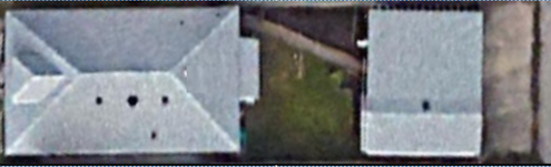

I am buying a brand new Worthington propane tank for general purpose, torching, bbq etc.
My issue is where will I store the propane tank in summer season i have following area outside the house and then I have basement.
I dont want it to get stolen in summer season if somone from alley jumps in the house from fence and steals it.
not sure what you guys do for propane tank storage.
Thankyou

a big dog that would guard the propane tank in the summer while the tank is sitting in your yard. 1670342791890.png

Sorry you live in that environment. A chain may be insurance, but then thief will seek next target. Just had a thought, A trash can with no bottom!
oh yea, inverted trash can with holes for ventilation will cover it, you are genius!!!
but in summer the temperature outside the house reaches 39 real feel, I hope its ok because I see stores keep their tank outside in same heat and summer for sale.

It's best not to. Explosive and inflammable stuff should live in a separate shed. One where you won't cry too much if it goes whoosh or boom. Say, a little garbage can shed.
That said, I have enough compressed air and oxyacetylene to launch a Saturn V in my shop. But I keep my propane and gasoline in a separate structure. Mostly cause I've noticed that they have a tendency to leak.
