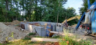

ChevSub89
Sep 18, 2020
12
House
Forms went up in a day, with concrete poured into the footings the next. After about a week for concrete to set and the town to inspect they were back to do the foundation.

ChevSub89
Sep 18, 2020
12
House
We actually lucked out on placement for the garage. We abut a drainage easement on two sides and placed the garage foundation right on the lines - with town approval of course. This in turn gave us much more usable yard space which we weren't even planning for! Bonus!
